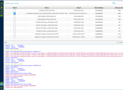

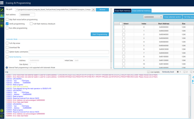

Hi, we are using STM32H750IB and one MT25QL512A on our board, I downloaded "CLIVEONE-MT25QL512A_STM32H7XX-PF10-PG6-PD11-PF9-PF7-PF6.stldr" from GitHub and copied to ExternalLoader directory of STM32CubeProgrammer. Run STM32CubeProgrammer, selected this flash loader, but still get error on accessing the flash. Did I miss anything? We use the same pins for the QSPI flash and I can read and write the flash memory correctly with the code from the discovery board. Thanks for your help.
