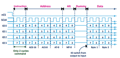

The memory is supported if the command format is in line with the OCTOSPI controller frame format (AN5050):

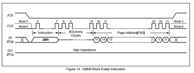

But, according to the memory datasheet, Block Erase (D8h) command needs the address after the dummy bytes.
Thank you.

Thank you for your answer. I know that it is necessary to send an 8-bit dummy after the SECTOR ERASE command. You can see this if you look at the end of the tables. I think the source of the problem I am experiencing is different.
3. Sector Erase:
a. WRITE W25XXX_OP_BLOCK_ERASE (BLOCK ERASE 0xD8 = 0x0000 )
WRITE | DUMMY | READ |
0xD8,0x00,0x00,0x00 | 1 BYTES |

To clarify my last comment, the microcontroller sends the OCTOSPI command fields in the following order:
- Instruction
- Address
- Alternate bytes
- Dummy
- Data
But, the erase command needs the address after the dummy bytes, not before. This command does not follow the order supported by OCTOSPI controller frame format.
Please take a look to this discussion.
Thank you.
Kaouthar
‎2023-11-20 3:11 AM
Thanks again. I know that. Erase sector sequence is COMMAND+DUMMY BYTES+ADDRESS. But order is not important for my example. My Address= 0x0000 and I write dummy bytes as 0x00. My output data is 0xD8,0x00,0x00,0x00.
