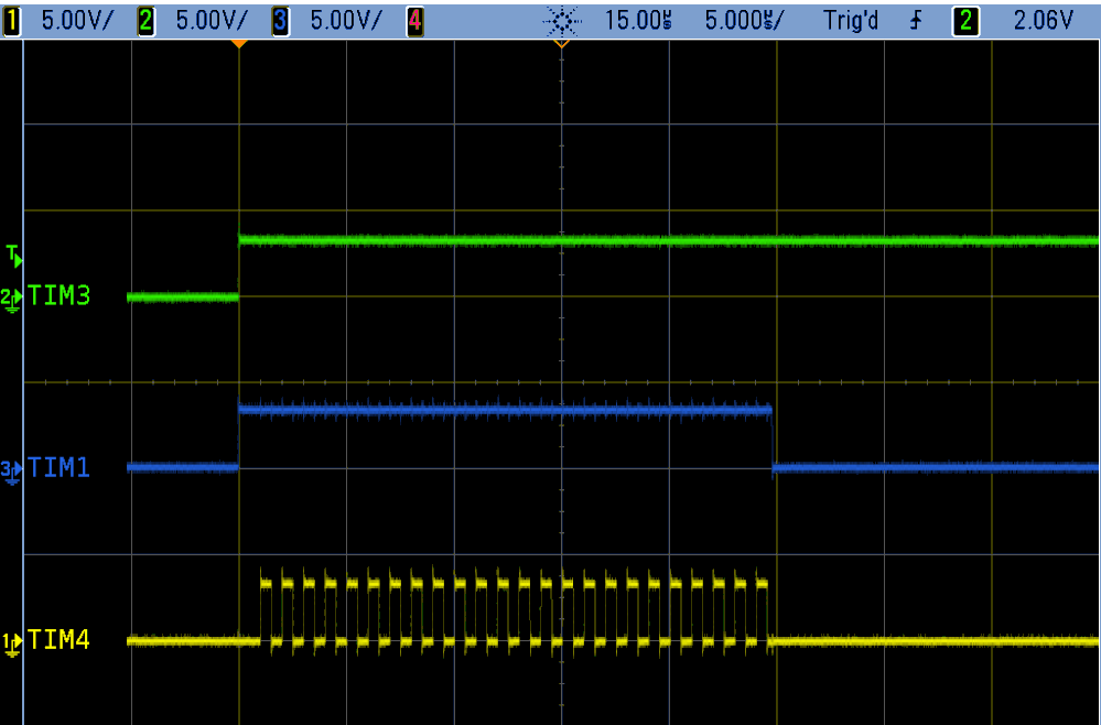

I'm trying to get exact 2048 pulses with TIM4 on Channel 1 at PB6 with a frequency of around 3 MHz after an TRGO from TIM3. Sounds actually quite simple but I've tried already the following which dosn't lead to the correct result:
&sharp1. Timer Cookbook 6.2, Example Part 1: Is not working, here the TIM1 repetition count is used which is only able to generate 256 pulse.
&sharp2.
Timer Cookbook 6.3, Example Part 2: Because of the TRGO feedback from TIM1 into TIM2, TIM2 cannot triggered extern via another hardware trigger.
&sharp3. I've tried the following TIM3[Update]---ITR2---->[Trigger] TIM1[OC1REF]---ITR0--->[Gated]TIM4 --->Ch1 PB6. Which is working, but unfortunately TIM1 is tied to APB2 where TIM4 is to ABP1 and therefore the obtained pulses are not correct and they shifting. See the gif.
&sharp4. I've counted with TIM2 the TIM4 counts: TIM3[Update]---ITR2---->[Trigger] TIM4
[Update]
---ITR3--->
[Trigger]
TIM2
and triggered an software interrupt after 2048 is reached and manually stopped TIM4. This is not working, because of the delay in the interrupt routine. I got a variation of 2 - 4 counts too much...Are there any other suggestions how to solve this?

Thanks for your reply Seb. Your idea sounds good. The only drawback is, that I block quite a lot of RAM with this solution. Is it possible to readout from FLASH with DMA?
Anyway, I got it working now. I can set a high amount of pulses (like 2048) and it is working fine. I count the number of pulses with TIM1 to check. My timer setup is:
TIM3[Update]--ITR2-->[Trigger]TIM2[OC1REF]--ITR1-->[Gated]TIM4[Update]--ITR3-->[Ext.Clock]TIM1
There were some pitfalls which I had to manage:
1. Don't use TIM2 and TIM4 in OCFastMode. So the setup has to be TIM_OCFAST_DISABLE, otherwise strange things like you see in the GIF will appear.
2. TIM2 is in OnePulseMode. The delay (Pulse) has to be very high to prevent strange behaviours with the TIM4 output pulses. If the delay is too short, in my case the first up to 10 pulses of TIM4 have a varying duty cycle.
3. The clock prescaler for TIM2 and TIM4 has to be zero (Prescaler = 0). On my STM32F446RE the clock prescaler caused a lot of jitter on the TIM4 output pulses. I had an inaccuracy of around plus minus 50 pulses by an amount of 2048 setting the prescaler unequal to 0.
Hope this will help someone else.
