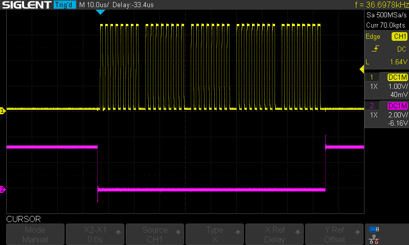

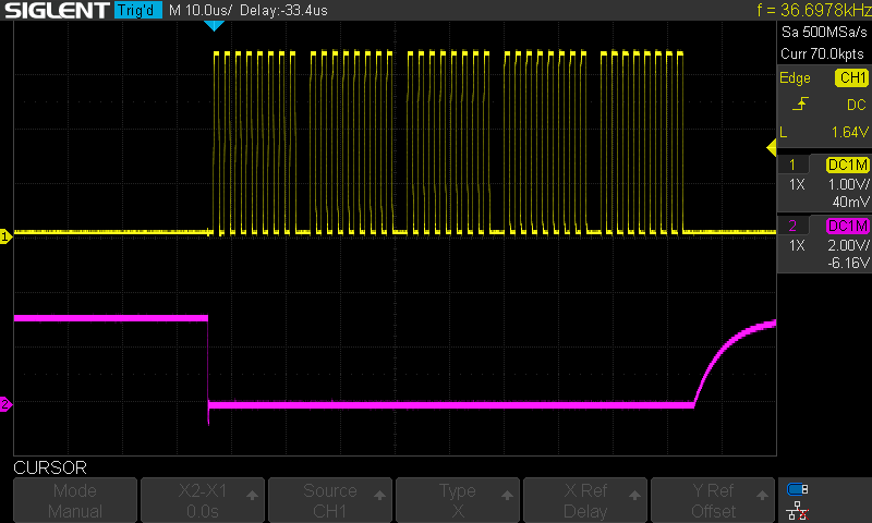

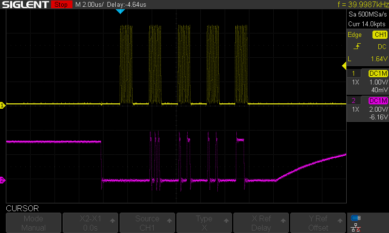

This is some screen of the signals :
CS :0693W00000Ba11uQAB.pngMOSI :
0693W00000Ba12YQAR.pngMISO :

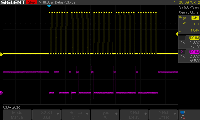

I have a screen of a workwell MISO (in the same case) if you want to see how it's should looks like :

No look at correct MISO screenshot the screen need to return me some datas ! If he returns me 0 he can't continues his initialization.
