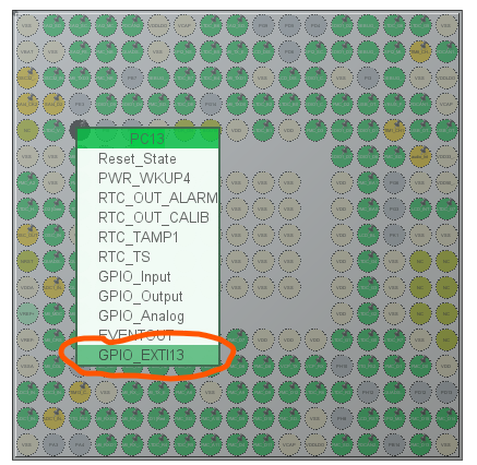

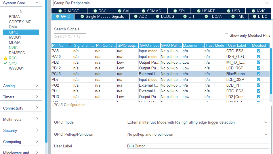

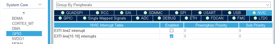

@CG3​ It looks like you just want to blink the LED while the push button is pressed but doing it in a while loop is blocking, so you can't do any other tasks.
So instead use EXTI on PC13
_legacyfs_online_stmicro_images_0693W00000bhiQMQAY.pngThen enable interrupts in NVIC
Then set the GPIO mode for interrupt mode on both Rising and falling edge
Then follow this YouTube video below on how to debounce a push button and also blink an LED all without using blocking code. So even if you are pressing and holding the button, the LED can be blinking while you can do other tasks like parse UART messages, communicate with I2C devices, etc.
