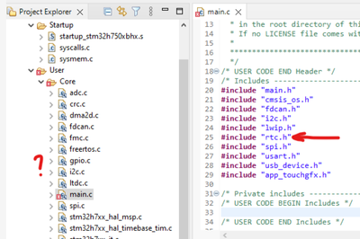

I'm getting this below compile time errors...
undefined reference to `MX_RTC_Init'
However, I have included the rtc.h header file, which contains the declaration of the MX_RTC_Init(void) function.

The file rtc.h is located in the Core/Inc folder, and rtc.c is situated in the Core/Src folder. However, the header file is not appearing in the Project Explorer of CubeIDE. Regrettably, I am unable to share the entire project. Thank you for your understanding.
Header files don't need to be listed in the Project - they are found via the #include directives in the code.
More importantly, the rtc.c file is not appearing in your Project - it should be in that list you've marked with the question mark:
That'll be why it's not being built and, thus, why there's no definition for MX_RTC_Init
