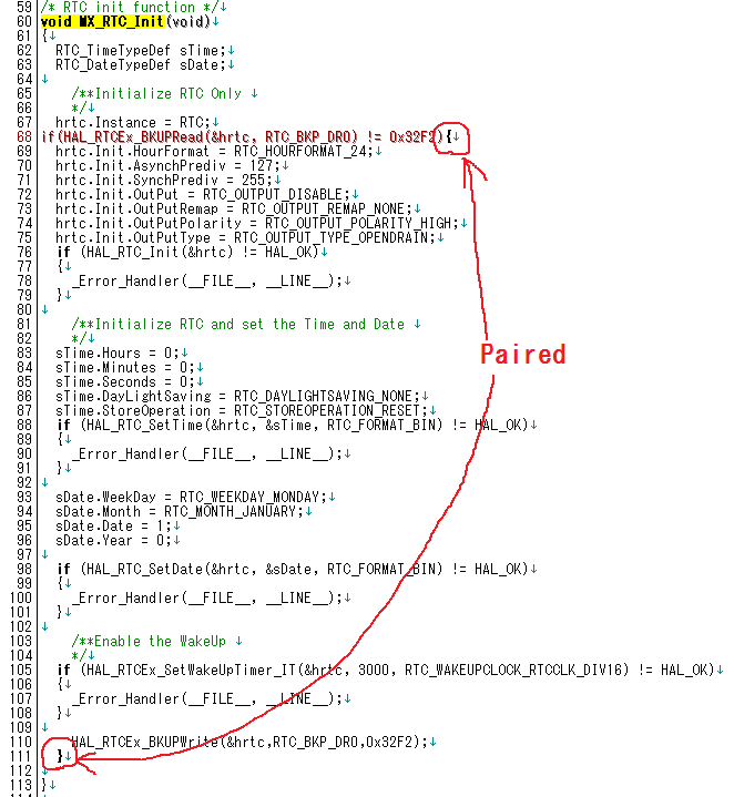

Hello! I've found a bug in RTC adjustment, when I used STM32CubeMX 4.24 for STM32L0.
MX_RTC_Init does not activate RTC because of HAL_RTCEx_BKUPRead/HAL_RTCEx_BKUPWrite 'guard'. For example, 4.23 version did not wrap HAL_RTCEx_SetWakeUpTimer_IT in HAL_RTCEx_BKUPRead/HAL_RTCEx_BKUPWrite 'guard'. Please, compare the attached files.

As I see, `if(HAL_RTCEx_BKUPRead(&hrtc, RTC_BKP_DR0) != 0x32F2){` line moved up and are called before `HAL_RTC_Init(&hrtc)` function. I think new version is better as it checks if the previous RTC data are saved correctly. This tells us that RTS battery are Ok and no need to initialize RTC again. Your RTC settings from previous MCU start will be saved. To change time you must to create custom function, may be based on MX_RTC_Init() and call it when you need to set time.

Posted on April 25, 2018 at 10:31
Hi, Imen D.
I tried with these.
  STM32CubeMX 4.25.0
  STM32Cube FW_L4 V1.11.0
  NUCLEO-L476RG
Generated MX_RTC_Init(void) function in rtc.c is,
The problem John Smith said looks alive.
------John Smith said----------------
Thanks.

I'd just like to second that this is a problem. I'm using 4.25.0, and
STM32Cube_FW_L0_V1.10.0 and the 'Write Guard' also encompasses too much. I have a program which looks something like:
Do some stuff...
HAL_RTCEx_SetWakeUpTimer_IT(&hrtc, (
uint16_t
)counter, RTC_WAKEUPCLOCK_RTCCLK_DIV16)
HAL_PWR_EnterSTOPMode(PWR_MAINREGULATOR_ON, PWR_STOPENTRY_WFI);
Do some more stuff...
HAL_RTCEx_SetWakeUpTimer_IT(&hrtc, 5, RTC_WAKEUPCLOCK_CK_SPRE_16BITS);
HAL_PWR_EnterSTANDBYMode();
The first time through, it works. But when the uC returns from STANDBY, it does not do a HAL_RTC_Init because of the 'Write Guard', and when it enters STOP mode, it never returns.

Posted on April 26, 2018 at 18:07
It's very simple and reproducible. If the Write Guard prevents the HAL_RTC_Init call after the uC returns from STANDBY, the STM32 hangs in HAL_PWR_EnterSTOPMode. If the Write Guard is after the call to HAL_RTC_Init, (where it was originally) HAL_PWR_EnterSTOPMode awakens, as expected, after the RTC Clock expires.
Nawres GHARBI
Posted on May 02, 2018 at 12:16
hello,
will be fixed next release
