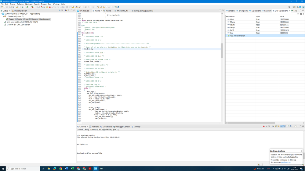

why i am getting same values in all channels please someone help

3 REPLIES 3
raptorhal2
Lead
You are converting only one channel at a time. Set NbrOfConversions = 1.

meena
I am getting  same values for all channels
