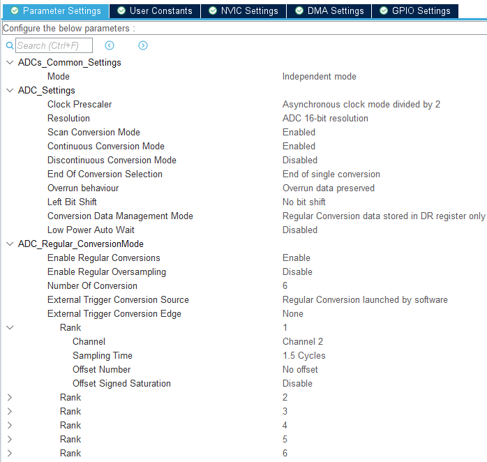

Using an STM32H757-EVAL (don't use CM4) with CubeMX. Configured my ADC1 as follows:

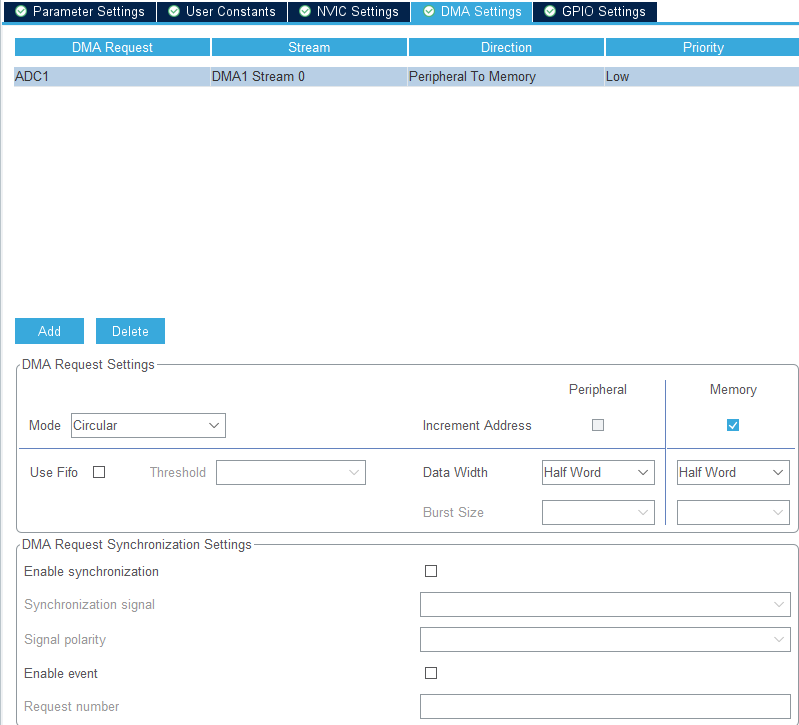

_legacyfs_online_stmicro_images_0693W00000bjjM0QAI.pngDMA is:

My expectation is that after the call to the HAL_ADC_Start_DMA, the ADC should scan all 6 channels continuously and put resulting conversions into the m_hv_status_values circular buffer sequentially. Any suggestions would be appreciated.

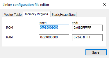

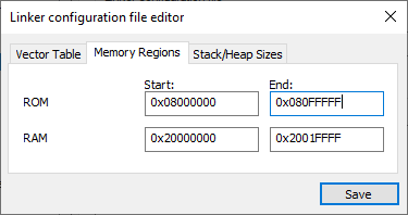

Thanks S.Ma, it works now. I changed the RAM location from this:
_legacyfs_online_stmicro_images_0693W00000bjoKEQAY.pngTo this:
Not sure why this change is needed. If you understand why this is needed, please let me know.
