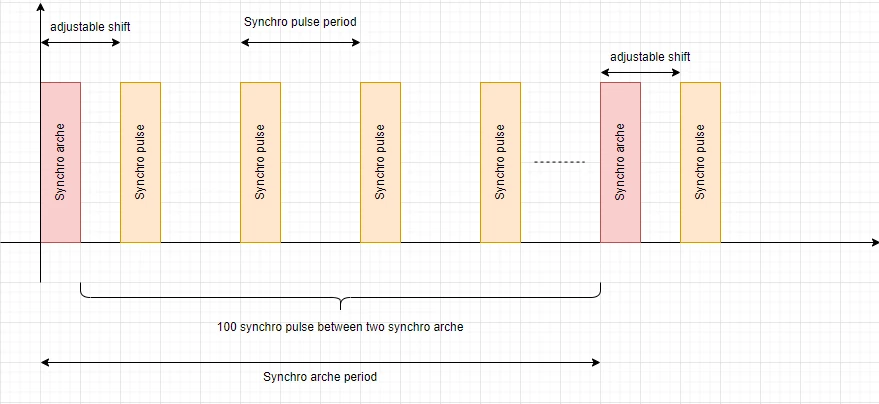

I'm facing a problem with a master timer and slave timer on Nucleo-STM32H723ZGT6U. To better understand my issue, I will present you my project.
Project presentation
My aim is to make two PWM signals like this :
The red signal is named "synchro arch" and the orange one "synchro pulse". Both have their own duty cycle, the period of synchro arch is 100 times the synchro pulse period and there is a shift (delay) between the two signals.
The duty cycle of synchro arch, the duty cycle of synchro pulse, the delay and the period of both timers are programmable using UART commands.

As nothing is perfect :,) I'm facing a problem when I try to modify on the fly the period of the signal. I enter my custom UART command to modify the period "PERIOD SP = 503", I isolate the command (PERIOD SP) and I isolate the parameter (503µs). But here, the two timers (master and slave) are desynchronized :o
I also notice that when I set period multiples of 100 like 100µs, 200µs, ..., 500µs I have no problem, the timers are synchronized, but otherwise (503 µs for example) the timers are desynchronized.
Please do you have any idea to fix this problem ? I attach the code of the timer module to help you.

The proper method will depend on what output you want, specifically, under certain conditions, specifically when things can be updated at arbitrary times. If you only allow changes at the start, or if you allow things to be temporarily out of sync for a cycle, it becomes a bit simpler.
What values are you changing? If it's all of them, then how are the timers expected to stay in sync?
Say synchro pulse period = 500us, and arch period = 50ms. Okay, 100:1 ratio, no problems then. Now you say synchro pulse period = 503us. That's not a divisor of 50ms, so what do you expect the output to be? Or should the period change to 50.3ms now? Or do you still want 100 pulses and then the last one has a larger delay before the start of the next cycle? It's unclear in the problem statement.
One way to keep them in sync is to stop the timers, set up new values, and then restart them from CNT=0.

"Or should the period change to 50.3ms now?"
Yes exactly! In the main module, when I receive the command PERIOD SP = 503 I do this :
I stop the timers with stopPWMGeneration like this:
Then, I execute the setSynchroPulsePeriod function :
This function set the synchro pulse period AND the synchro arch period (by multiplying by 100).
When I set the ARR registers and recalculate duty cycle (CCR1), I restart timers with startPWMGeneration :
"Or do you still want 100 pulses and then the last one has a larger delay before the start of the next cycle? It's unclear in the problem statement."
While I have Tsa (period of synchro arch) = 100*Tsp (Period synchro pulse) it is good for me :)
"The proper method will depend on what output you want, specifically, under certain conditions, specifically when things can be updated at arbitrary times. If you only allow changes at the start, or if you allow things to be temporarily out of sync for a cycle, it becomes a bit simpler."
Good point! I need to change all the values ... but I need that the previous cycle end and that the next cycle begin after. Indeed, I don't want that a synchro arch happen during the current cycle :
This case must never happen :
But this case is acceptable
So ... "last one has a larger delay before the start of the next cycle", the answer is yes
