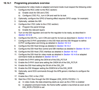

Hello! I'm now using a STM32F469 to drive a screen with MIPI-DSI Interface. I need to send the initial codes with low power command transmission, and then drive the screen in video mode. I think LPDT it is supported by this MCU, but I'm not sure how to use it. Could anyone give me some advice or instructions?
Hi @123scy321,
Yes, you can refer to the Reference Manual RM0386, specifically section 18.14.1 Programming procedure overview. This section explains the sequence of steps to configure the DSI Host and the LTDC, including the initialization phase in LP mode before starting the video signal.

Thanks! One more question, the screen is required to be initialized in LP mode. And the video signal will be sent afterwards. Is it possible to halt the video signal to initialize the screen at first?
Hi @123scy321,
