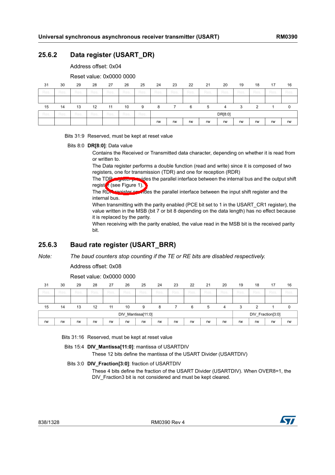

''Figure 1'' here:
should probably be ''Figure 279. USART block diagram''.
I see the same mistake in RM0090 rev.17, so this will be probably across several RMs.

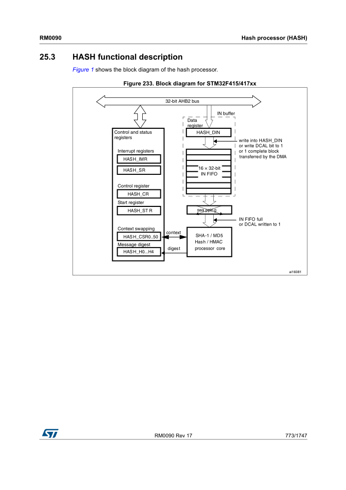

[EDIT] Textual search for ''Figure 1'' brought up also this one:
this of course can't be found in RM0390.

Thank you for bringing this to our attention.
I will raise this for update in all impacted reference manuals.
