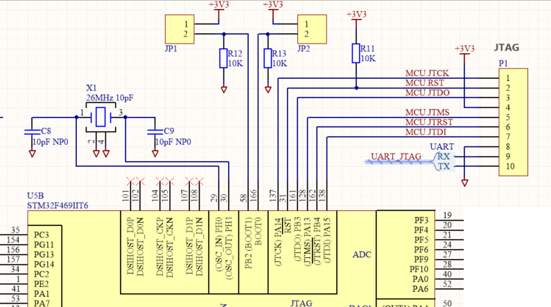

I am using the STM32F469 on three devices. One device works fine and starts normally after the power is applied. The other two only start operating after the nRST pin is briefing pulled low. There is 3.3V on nRST after powering it up, indicating the power on reset is ok, but the micro fails to start running.
Attaching the STM debugger and checking the MCU core it says it is halted. Clicking run starts the device working.
What could cause the device to power up correctly but not start the program running?

Anything else driving the pin in your circuit? You don't want any other push-pull drivers on the pin, the pin should have it's own pull-up.
Posted on December 12, 2016 at 02:55
No, the pin is currently floating.

It is probably not related to that, but I'm not much for 'guess what's wrong with my mystery board'.
If you want me to look at the schematic, or portion of it, you can post that.

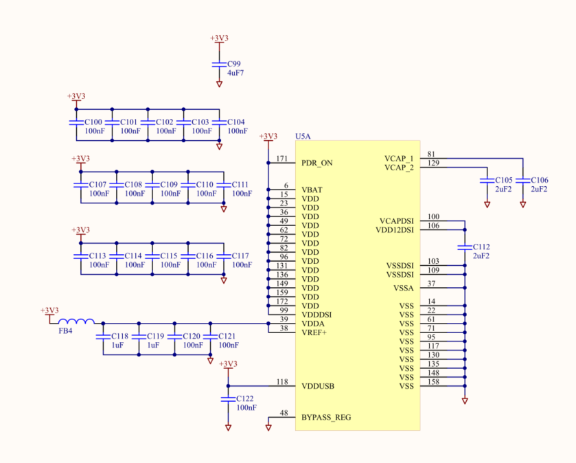

Things to be looking at are the analogue supply side (used by the reset circuitry), how the supplies ramps as power is applied, the value of capacitors on VCAP pins, and voltage measured there. Look at what is going on with the low-power domain pins, PC13, 14 and 15
Make sure BOOT0 and BOOT1 have defined states a boot up. Pull BOOT0 low.

VCAP_1 and 2 are 2.2uF. 1.32V on both.
PC13, 14 and 15 are being used a chip selects and measure 9mV on startup. What are their importance?

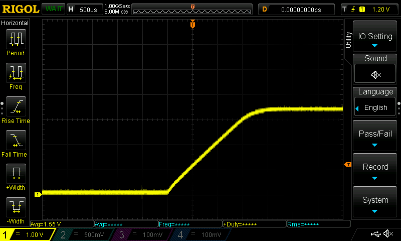

The 3.3V supply is ramping on in about 2ms. Is that possibly too fast?

- DS states VDD ramp min.20us/V so 2ms/3.3V should be OK

- try shorting FB4
- I've never seen 2uF2 style of separating decimals (only 2u2 or 2.2uF, or 2M2/2.2M although this is perhaps not used since 80s) - made me think initially what the 2 suffix might meant... :-)
