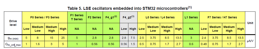

Regarding the calculation, you missed a factor of 5 . Pay attention between Gm(min)  used in the formula and the Gm_crit_max used in our newer datasheets.  0690X0000060LavQAE.png
gm [LSEDRV[1:0] = 00]=
0.5 uA/V
=> 2.5µA/V
gm [LSEDRV[1:0] = 01]=
0.75 uA/V
=> 3.75µA/V
gm [LSEDRV[1:0] = 10]=
1.7 uA/V
=> 8.5µA/V
gm [LSEDRV[1:0] = 11]=
2.7 uA/V
=> 13.5µA/V
Same for HSE ,  gm =
1.5 mA/V
7.5mA/V
