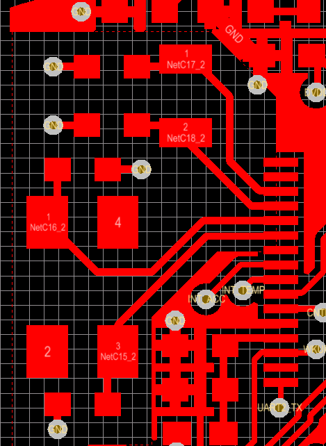

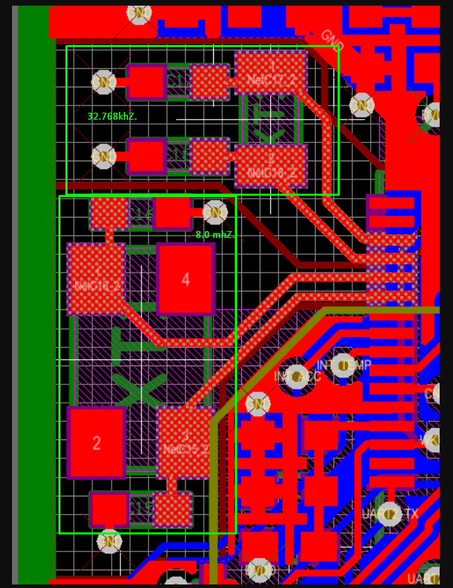

Posted on June 28, 2018 at 07:55
Hi STOne-32,
This is the footprint:
And the track length:
For the 32.768KHz crystal: 6.731 mm and 4.786 mm
For the 8.0MHz crystal: 8.176 mm and 9.874 mm
Do you think the PCB design is good enough?
Best regards.
STOne-32
Posted on June 28, 2018 at 10:46
The design seems good.  Can you please share all Layers seperatly to check the Vias and Ground connections.  I fear there is a ground loop creating a leakage somewhere, but to be confirmed.
Cheers,
STOne-32.

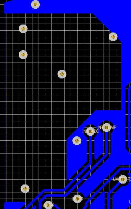

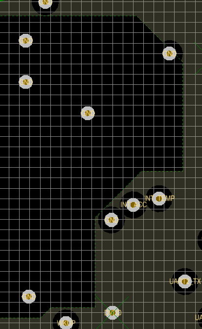

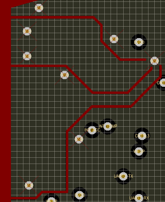

Posted on July 03, 2018 at 08:03
Hi STOne-32,
I'm sorry for the delay. I send you all layers seperatly.
TOP:
L1:
L2:
Bottom:
