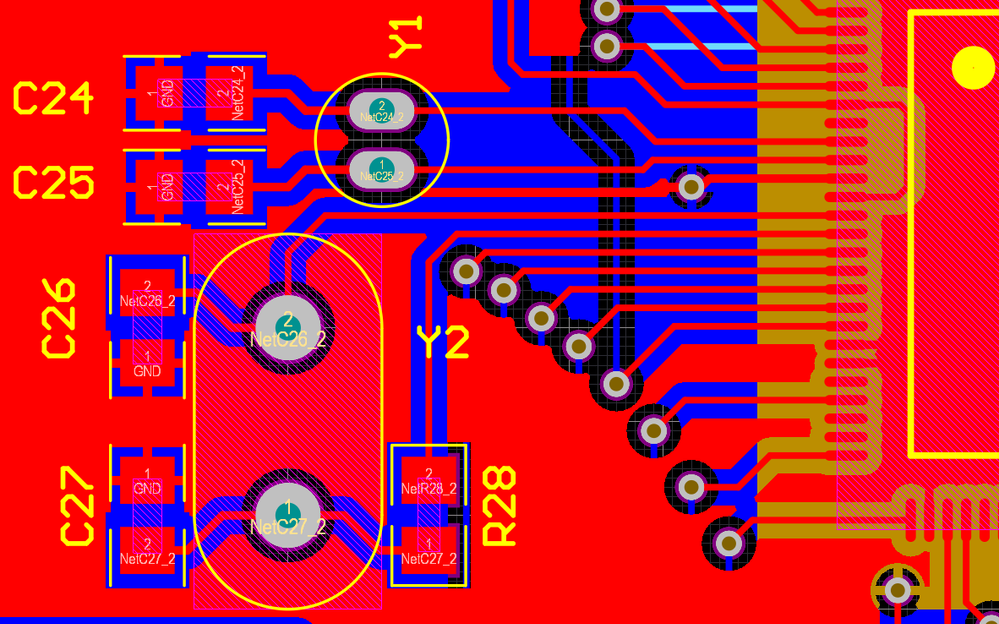

I have read all other posts of LSE problems in the forum and found a lot of info, almost everything related with hardware or PCB layout, well, i have to admit that my pcb layout is not the best and the hardware parts either.

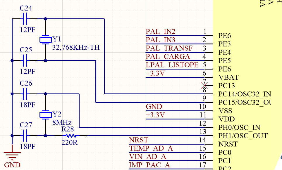

Hardware:
Schematic:
PCB layout:
The parts i’m using are:
Microcontroller: STM32L431VCT6
Crystal: https://www.digikey.com/products/en?keywords=631-1204-ND
Capacitors: 12pF as indicate the crystal datasheet.

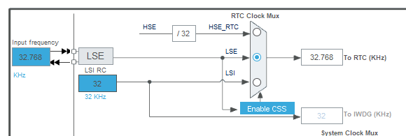

RCC config:
Clocks config:

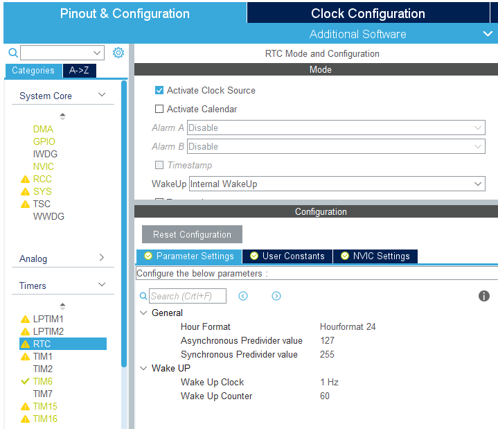

RTC config:

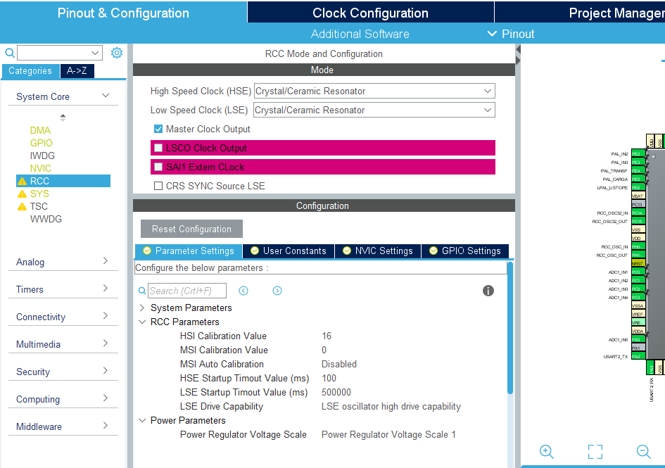

The program works well, but the problem is that the LSE don't start (the program get stuck) until a reset pulse or running the code under debugging. And if i power off and power on the board, the LSE get stuck again.
I tried almost everything, changed the LSE startup timeout, the drive capability, tried with different parallel resistors to the crystal, cleaning and drying the board.
I haven't tried changing the capacitors because i don't have any, but i can get some to try.
The problem happen in all the boards

The Load capacitance given by DS does not mean you put two capacitors of that capacitance next to the crystal. Read AN2867.

C24/C25 are almost certainly too big.

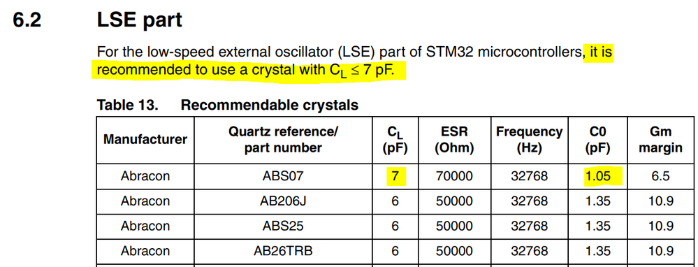

Look at AN2867 for how to calculate what the capacitors should be.
https://www.st.com/resource/en/application_note/cd00221665-oscillator-design-guide-for-stm8afals-stm32-mcus-and-mpus-stmicroelectronics.pdf
They also list some recommended parts. Note that C0 is way less than what you have.
