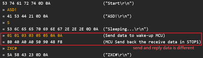

Hello everyone:
I'm working with board NUCLEO-U031R8, and need to wake up when LPUART receive data which using LSE with 32768Hz.
MCU would send back the receive data which end with '\n', and it works fine in running mode, and a special command 'S' let MCU go into stop mode and wait next data, and send back receive data when wakeup.
The receive data length is correct while wakeup in stop mode, but the receive data is broken, and if has next command it will reply as normal, the communication like this:
And here is the sample code:

Anyone have any idea what's going on?
Regards.
