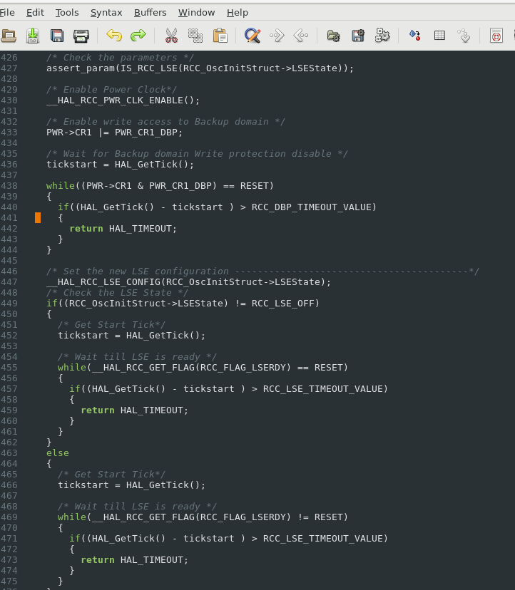

I've got a development board based on the STM32F746 from Mikroelektronika. The board has a 32.768 kHz crystal connected to the LSE oscillator pins. I can't get the oscillator to start and come ready.
Here's my code--any idea what I'm doing wrong?
 * Start the LSE (32 kHZ) oscillator
    RCC->APB1ENR |= RCC_APB1ENR_PWREN;        // enable PWR interface clock
    PWR->CR1 |= PWR_CR1_DBP;                                  // disable backup domain write protection
    RCC->BDCR |= RCC_BDCR_BDRST;                        // reset backup domain
    RCC->BDCR &= ~RCC_BDCR_BDRST;                    // deassert backup domain reset
    RCC->BDCR |= RCC_BDCR_LSEON;                        // enable LSE oscillator
    while(!(RCC->BDCR & RCC_BDCR_LSERDY))
                 ;                                                                             // wait for LSE ready
    RCC->BDCR &= ~(0b11 << 8);                                      //
    RCC->BDCR |= 0b01 << 8;                                            // select LSE as RTC clock
    RCC->BDCR |= RCC_BDCR_RTCEN;                        // enable RTC

If you take a look into the ST code, there is a wait loop right after you enable the write access to backup domain. It can happen that you are configuring the LSEON bit while you can't...
I know you mentioned you are stepping through the code, but maybe...

Good point. I'll try putting in some delays and see if that helps.
