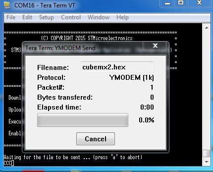

Hi kk,
Thank you for your reply! I modified the program, and I got the main menu. But when I use YModem to download my program, it is always blocked at 0%. Have you ever encountered this issue?- Mark as New
‎2016-02-01 8:55 AM
Not sure you want to be sending .HEX, seem to think ST example expects executable binary code to be delivered.

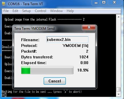

Dear ttl,
As I can see from your screen shot, you are sending .HEX file but if you are using ST IAP example it only accept .BIN file(Clive1 also told the same
). So try with .bin file. I tested this Ymodem file transfer with Hyperterminal.- Mark as New
‎2016-02-02 12:52 AM
I tried the .bin file. It is blocked at 18,9 %.
