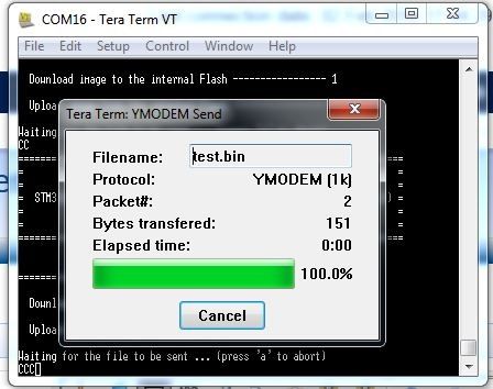

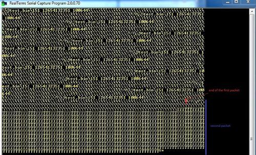

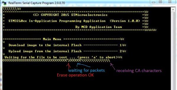

‎2016-02-03 8:20 AM
After the ''inspection'', the program is not stuck in the uart_waitonFlagtimeout. The characters ACK and CRC 16 are sent. But, i cannot see them with tera term.
Using the realterm, i see more details. The program sends ''CA'' characters after the ACK and CRC 16 of the memory erase. But, there is a strange phenomenon, during the file transfer, there are only two packets received. The first packet includes the file name,size ..and the second packet includes the data. Then the communication is abort, and I receive CA (0x18). When I check the memory, this one is not written with the only received packet of data. There are only zeros in the memory.
