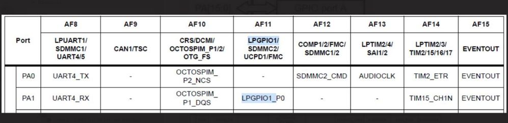

For a basic test to verify the hardware of my PCB is OK, i want to make a loopback between PA0 and PA1, I see on the stm32u585ci doc that PA0 can not be configure as simple GPIO (PA1 is possible)
It is correct?
It is correct?
No, I think you're misinterpreting that table:
Those are Alternate Functions (hence "AF") - ie additional (or "alternate") things that the pin can do besides being a "simple GPIO".
When not configured with an AF, all pins function as "simple GPIO".
