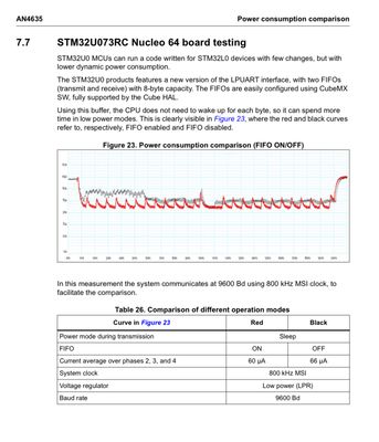

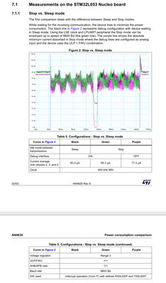

I can adjust the baud rate according to U0 capabilities to a degree. What's the maximum baud rate supported to wake up from STOP mode upon LPUART RX?
Dear @mlac ,
Here you go
https://www.st.com/resource/en/application_note/an4635-how-to-optimize-lpuart-power-consumption-on-stm32-mcus-stmicroelectronics.pdf
L0 use case
U0 use case at the end as example of concrete example with power consumption
 Hope it is inline with your budget , but please note it is base on a superset U07 with more RAM and Flash so with U03 is much more reduced for consumption.
Cheers,
STOne-32
