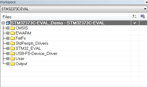

I've included STM32_USB-FS-Device_Driver in my project. When I compile (in IAR) I get a bunch of errors

I've just opened a demo project (from STM32373C-EVAL_FW_V1.0.0) and it compiles OK - with this library (STM32_USB-FS-Device_Driver).
But in my project the library compiled with errors.

So there is something wrong in your project causing the duplication.
Compare the two projects.
