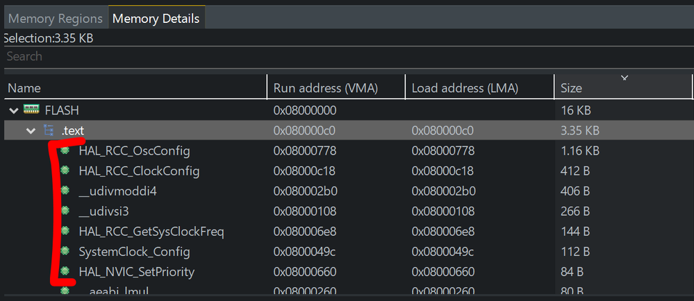

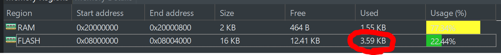

I need a to read and write a simple 16 bit user configuration value that's stored in non-volatile memory. The STM32L0xx is famously short on memory and as such bringing the entire HAL in is out of the question. It swells up the code space well beyond 8k!
Is there a simple way to save and read a value from flash (virtual eeprom)? Maybe a couple of assembly instructions? I can't find an example of this anywhere. It sure would be nice if there was just a simple __no_init pragma that handled the unlock, write, lock... without a lot of HAL or wear leveling complexities.

You can just use the HAL functions you want and it won't increase code size that much. Most of the space is due to complicated clock initialization functions.
