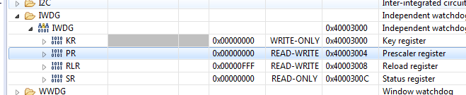

Furthermore I have check too that the registers are right configured:

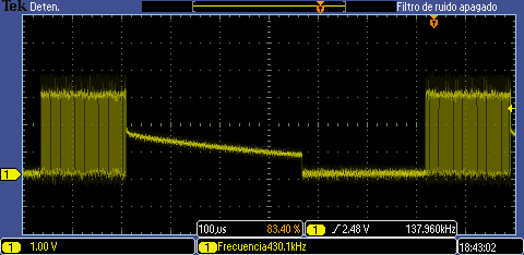

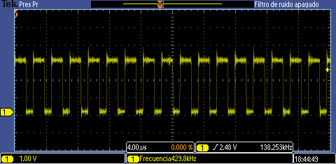

Posted on February 23, 2017 at 19:34
I have already test that the reset code is been executed. I have already monitoring with a GPIO output. As I show:
while (1)
HAL_GPIO_WritePin (GPIOD,GPIO_PIN_12,GPIO_PIN_SET);
HAL_IWDG_Refresh(&hiwdg);
HAL_GPIO_WritePin (GPIOD,GPIO_PIN_12,GPIO_PIN_RESET);
The results are:
hiwdg.Init.Reload = 0; (teorically 125us IWDG period) Reseting continuously the whatchdog in the main (429,8 kHz or 2.326 us aprox)  the system do a reset.
Fig1
Fig2
hiwdg.Init.Reload = 1; (teorically 250us IWDG period) I have the same result than in the Fig 2 but without interruption due to a reset.

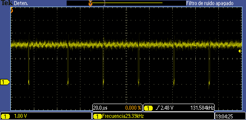

In this case I have introduced a delay with a for loop:
while (1)
for(uint32_t i = 0; i < 150; i++);
for maintain the system working I need to do the reset the IWGD at a frequency of  29,39 kHz (each 34,02 us);
Why I need reset the WD counter 7 times faster than it runs? That is what I do not understand.
