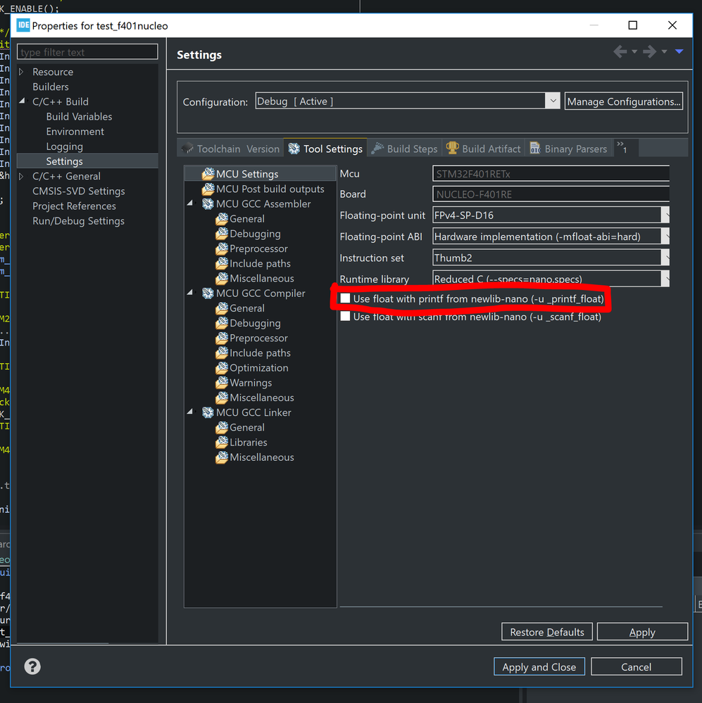

Ran into some issues writing float data to the UART. I know with Nordic, there was some weird workaround that had to be used to convert it that looked something like this:
 NRF_LOG_INFO("MLX90393 X = " NRF_LOG_FLOAT_MARKER "\r", NRF_LOG_FLOAT(*x));
I wasn't sure if there was some other trick for this, if there's a project related setting that is required to make use of floating point (in case it's disabled by default or something to that effect, etc). I tried finding one but didn't seem to find one in the project options.
Anyway, this is my current attempt at resolving the issue:

I expected it would convert it but the output for x_str is:

In STM32CubeIDE, there is a checkbox to enable support for floats within printf. If "\0" is a null character, looks like your current implementation simply ignores the "%f" specifier.

Things using GNU/GCC like CubeIDE might need you to explicitly enable, have float libraries, and full C libraries for printf/scanf, not lite ones.
Heh, yeah, I actually stumbled across that and enabled it and was poking around at it. Tried moving from sprintf to printf (since the prompt mentioned printf) but that didn't work. Went back to sprintf and it started working for y. Which is when things get odd (and kind of explain why I was getting some odd results) . . .

I assume the checkbox includes sprintf as well as printf. Obviously printf won't work unless you've explicitly rerouted printf output somewhere.
> char x_str[10];
> char y_str[10];
> char z_str[10];
Why did you change those from 30 characters to 10? Writing "X: %5.2f \n" needs more than 10 characters.
Sorry, meant to come back here and completely forgot once I got it working . . . You are 100% correct on this and that seemed to be the root of the issue. Oddly enough, it worked fine for getting the Y and the Z but not for the X. I had reduced it to get rid of the additional garbage output . . completely forgetting that it didn't matter as the line was getting terminated at the /n anyway (so none of that garbage data mattered).
