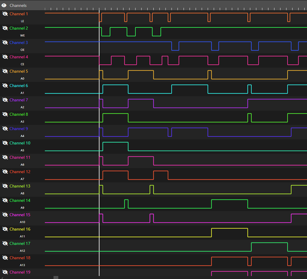

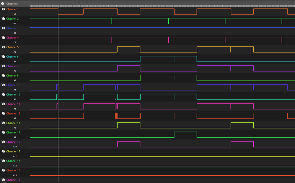

After analyzing what's going on on the FSMC bus I still cand fing any clues. Here is an example how it performs ReadID sequence, using standard HAL_NOR_ReadID
Everything looks correct, 3 sequences 0x555 - >0xAA, 0x2AA -> 0x55 and 0x555 -> 0x90, but reading 0x00 and 0x01 right after returns data from NOR not the deviceID
I've also tried bitbang mode with same pins and code below successfully reads deviceID. So after all it's not a witing problem, but maby timings or some FSMC setting

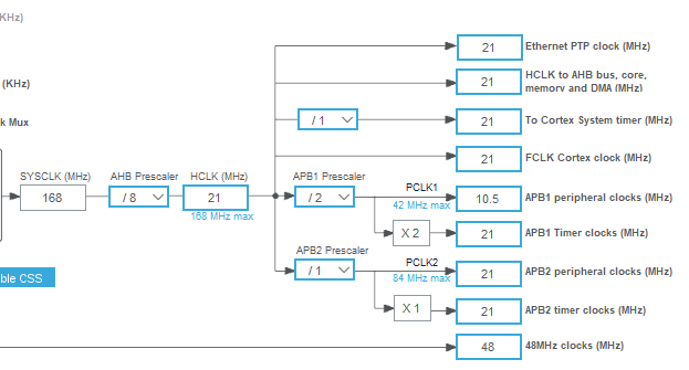

I've tried different timings but it has no effect. Currently it runs on 21Mhz

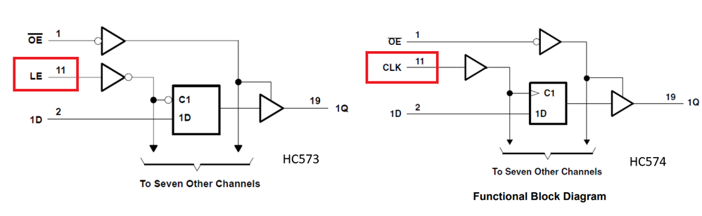

Not sure but you need to use a D-Type Latch (74HC573) having LE (latch-enable pin) instead of D-Type Flip-Flop (74HC574) (clock: CLK pin).
Hello

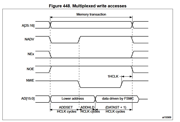

 74HC573 was my first attempt, but I've fugured out that it holds address only while NADV is active
Following RM0090 it will latch address only during ADDSET and during ADDHOLD it will again became transparent
With 74HC574 at least read operations works.
You need a latch not a D-type flip flop and indeed you need to add an inverter to the latch LE input.
