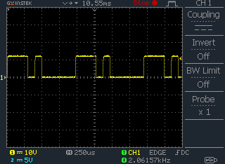

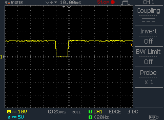

I am using an STM32F042 controller. I have to send a wake-up pattern followed immediately by 5 bytes (@10400 baud) from my device.
Wakeup pattern: 25msec LOW followed by 25msec HIGH
5 byte sequence: 0xC1, 0x11, 0xF1, 0x81, 0x44
I tried the following:
1) I configured the GPIOA, Pin 10, created a delay function and sent the Wakeup pattern. However, I am facing difficulties reconfiguring the GPIO into the USART Mode on the fly and then transmitting the 5-byte sequence.
GPIO_ResetBits(GPIOA, GPIO_Pin_10);
delay_nMSEC(25); GPIO_SetBits(GPIOA, GPIO_Pin_10); delay_nMSEC(25); usart1_init(10400);USART_SendData(USART1, 0xC1);
while(((USART1->ISR & USART_ISR_TXE) && (USART1->ISR & USART_ISR_TC)) == 0){}The above code does not work. I get the wakeup pattern correctly and then a single pulse of roughly 5msec after that. But no 0xC1. However, if I put the
in a while(1) loop, I get data transmission correctly. However, I need to transmit it only once.

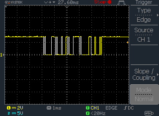

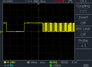

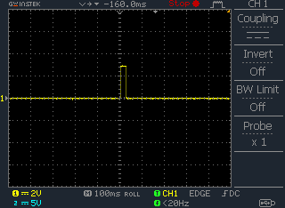

‎2018-07-03 4:42 AM
Waclawek.Jan
? -I tried the following piece of code:
timer16_config()
usart1_init(10400)GPIOA->MODER &= ~(GPIO_MODER_MODER0 << (0x0A * 2)) //Clear previous config of MODER
GPIOA->MODER |= (((uint32_t)0x01) << (0x0A * 2)) //Set MODER register to OUT mode//Wakeup Pattern
GPIO_ResetBits(GPIOA, GPIO_Pin_10) delay_nMSEC(25) GPIO_SetBits(GPIOA, GPIO_Pin_10) delay_nMSEC(25)GPIOA->MODER &= ~(GPIO_MODER_MODER0 << (0x0A * 2)) //Clear previous config of MODER
GPIOA->MODER |= (((uint32_t)0x02) << (0x0A * 2)) //Set MODER register to AF modeUSART1->CR1 |= USART_CR1_UE //Enable USART1
while(((USART1->ISR & USART_ISR_TXE) && (USART1->ISR & USART_ISR_TC)) == 0){}The above is the response I got on DSO.

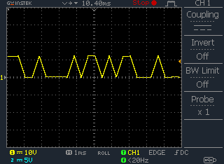

If say, I repeat the SendData command to the code,
while(((USART1->ISR & USART_ISR_TXE) && (USART1->ISR & USART_ISR_TC)) == 0){}USART_SendData(USART1, 0xC1)
while(((USART1->ISR & USART_ISR_TXE) && (USART1->ISR & USART_ISR_TC)) == 0){}I end up with this:
If I add the USART_SendData command to a while(1) loop, I eventually get my sequence, but that is after at least 100msecs
Eventually, after some time has passed:
Instead of the custom Hardware I have been using, I also tried a translated version of the code on my STM32F3 Discovery. I get the same response.
‎2018-07-03 6:25 AM
and
are clearly taken at different IO setting (or very different scope setting/external circuitry), given the edges/slope.
It's hard to discuss a moving target.

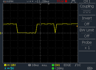

‎2018-07-03 6:56 AM
Hi
Waclawek.Jan
?,The only difference between the two images is that this is for
while(((USART1->ISR & USART_ISR_TXE) && (USART1->ISR & USART_ISR_TC)) == 0){} USART_SendData(USART1, 0xC1) while(((USART1->ISR & USART_ISR_TXE) && (USART1->ISR & USART_ISR_TC)) == 0){}while(1)
{// USART_SendData(USART1, 0xC1)// while(((USART1->ISR & USART_ISR_TXE) && (USART1->ISR & USART_ISR_TC)) == 0){}}while the following image: is for
// while(((USART1->ISR & USART_ISR_TXE) && (USART1->ISR & USART_ISR_TC)) == 0){}// USART_SendData(USART1, 0xC1)// while(((USART1->ISR & USART_ISR_TXE) && (USART1->ISR & USART_ISR_TC)) == 0){}while(1)
{ USART_SendData(USART1, 0xC1) while(((USART1->ISR & USART_ISR_TXE) && (USART1->ISR & USART_ISR_TC)) == 0){} }My GPIO config for USART1 remains the same as my original question. The MODER command works well when I converted from AF to OUT. However, OUT to AF is having the same effect as before.
The OD and PP configuration, while suspicious, is the only set which works for my external circuitry which converts the RX and TX into a single wire protocol. I needed the external circuitry because in another part of my code, I am also using the CAN functionality offered on the same pins.

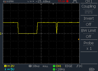

‎2018-07-04 6:04 AM
Waclawek.Jan
? - I am looking for issues at both ends (Hardware and Firmware). However, I am also simulating the same code on a F3 discovery board. I am getting the same response. On the F3 discovery, I am using the following:timer16_config()
