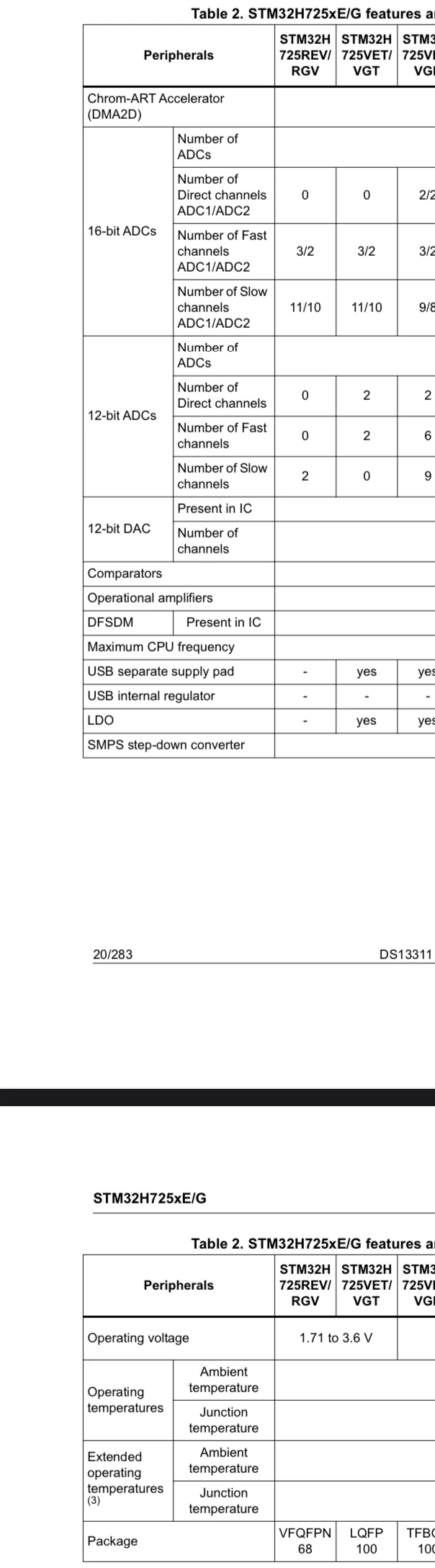

Best answer by STOne-32
Dear @genesis78 , @Tesla DeLorean ,
thank you for spotting that . This package is only SMPS or bypass and is mentioned in this table in datasheet also : LDO Line is empty
So yes , the PCB should be re-spinned to have SMPS / DCDC connections.

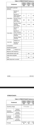

Per data sheet
Embedded DCDC and LDO regulator
(*)VFQFPN68 variant is DCDC only

genesis78Author
November 10, 2024
Thank you for spotting that. I initially discounted the LDO not being present because of this line in AN5419,
"When LDO is available but VDDLDO pin is not present on the package, VDDLDO is internally connected to
VDD," but I must've ignored "available" being a keyword.
I'm guessing that the PCB isn't recoverable since I would need another voltage regulator to continuously supply 1.35V to the VCAP pins. I'm also going to assume that the 2 MCUs I have used until now are fried since the core was probably being supplied with 3.3V.
The documentation for this specific variant is so lacklustre and confusing that its frustrating especially for a first time user. I guess I'll have to order another PCB and more components now which could've been so preventable.
Anyways, for future reference apparently the first picture is the correct direct SMPS supply, for STM32H725RGV6 in the VFQFPN68 package which aligns with AN5419's diagram (2nd) as VDDLDO is internally connected to VDD.
