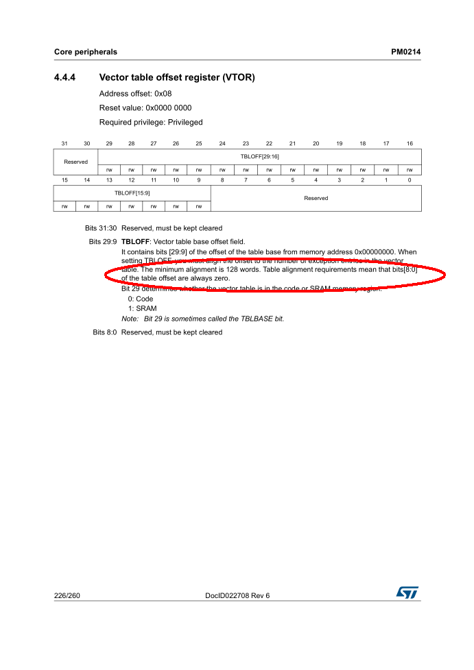

waclawek.jan
Posted on April 30, 2018 at 19:09
#define APPLICATION_ADDRESS  (uint32_t)0x08002030
    // Reconfigure vector table offset register to match the application location
   SCB->VTOR = APPLICATION_ADDRESS;
You didn't care to tell us what STM32, so I assumed Cortex-M4:

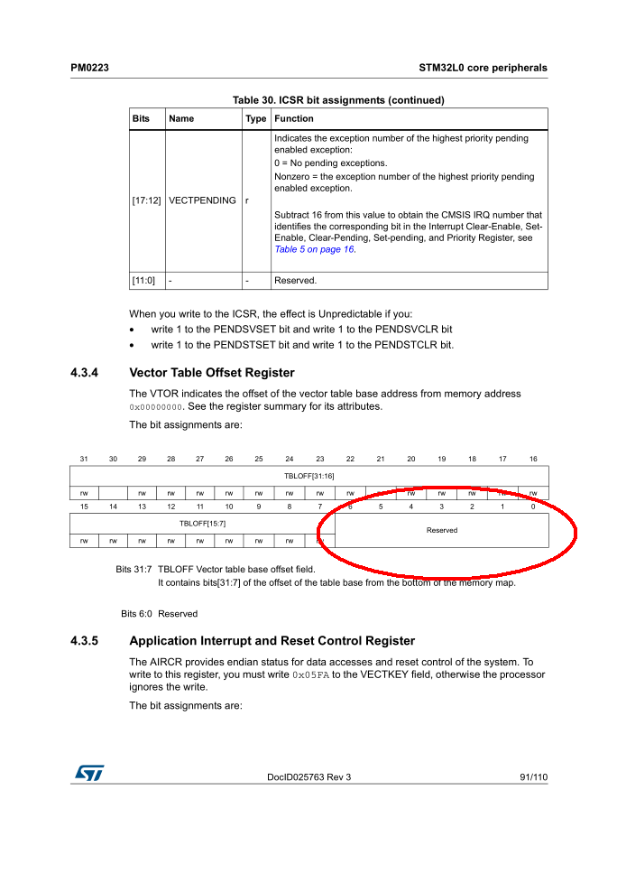

Posted on April 30, 2018 at 23:11
Im using a STM32L073 chip.
And then how hard is it to look it up in the respective Cortex-M0+ Programming Manual?
So, adjust the position of the table accordingly to the given granularity of 128 bytes.
Posted on May 01, 2018 at 04:28
Good catch, would expect it needs 256 byte alignment, the vector table is 192 bytes in size
Posted on May 01, 2018 at 10:40
Thanks for that
I only had the data sheet and the reference manual (which I couldnt see any reference on the VTOR register), I never noticed the programmers manual.
I never enabled any interupts in the bootloader, just polled the serial port and now works great.
Thanks for the help.
Scott
