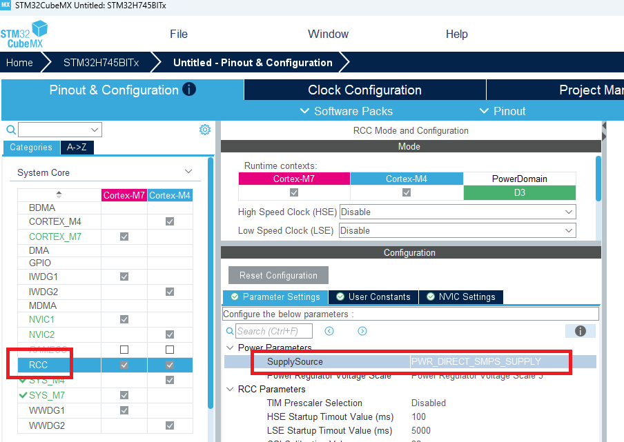

Could you also confirm whether any specific software configuration or initialization is required to enable the SMPS output?
Please use CubeMx tool to generate the code that reflects this configuration.

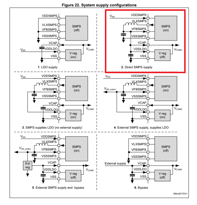

Thar reflects the following hardware configuration provided in the reference manual (RM0399):
Yes. I have tried the same configuration.
Neither that nor LDO supply, we are not able to dump the code.
The schematic you shared previously seems to tell that the power supply is in SMPS mode.
Hard to follow the connections in that schematic (bad rendering of the wires). I suggest you to get back to your hardware guy that has drawn that schematic and check again the hardware according to that what is shown in the reference manual Figure 22.
Maybe the hardware team can also explain why it's not working then.
Today's observation is that one of our boards worked with some changes with clock configuration.
Mainly changed PLL Source Mux from HSI to HSE and some frequency changes accordingly. (attached is the screenshot).
but same configuration it's not working with other boards.
Could you please explain.

But again you need to check with your hardware team the power schematics based on the Figure 22 provided in the reference manual.
Hi Team,
We have connected the hardware as per Direct SMPS Method with two numbers of 2.2nF capacitors at Vcap pin of the MCU. With this, we observed lot of ripple in the Vcap voltage and also observed Vcap dropping to below 0.65V and again recovering back. This was repeating a lot when board is just in Powered on condition.
However, we soldered a 4.7uF capacitor to Vcap pin and after that observed lesser ripple. We did not see the Vcap drop to 0.65V and all. Vcap was stable at this point of time. We properly observed Vcap rising to 1.2V at Power on and then staying at 1V till the board is in On condition. This is as per the Power On sequence from the STM32H745 reference manual Page 278.

When we checked Vcap, it is showing some 100mV value. With thi, we are observing that the Vcap voltage is going to 1.2V after power on but then falling to 100mV and staying there.
Please suggest us where we are going wrong and help us in solving this "Target lost" issue.
That's a hardware issue. I cannot determine what it is. As I said previously: check again your hardware. It could be also an issue with your PCB: solder joint issue, routing issue? I don't know ..
