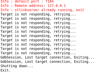

We are currently working with a custom board that uses the STM32H745BIT6 MCU, and we are attempting to connect it to the STLINK-V3SET debugger. However, we are experiencing intermittent debugging issues described below:
  1. The debugger successfully enters debug mode only 2–3 times when done the first time.
  2. In most cases, the debugger connects and enters debug mode, but after approximately 6–8 seconds, it displays a “Target lost” error (please refer to the attached photo).
  3. Often, it shows “Target not responding.” When this happens, we need to power cycle the board. After turning the power supply off and on again, it behaves as described in point 2.

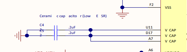

When we checked Vcap, it is showing some 100mV value. With thi, we are observing that the Vcap voltage is going to 1.2V after power on but then falling to 100mV and staying there.
That's a hardware issue. I cannot determine what it is. As I said previously: check again your hardware. It could be also an issue with your PCB: solder joint issue, routing issue? I don't know ..

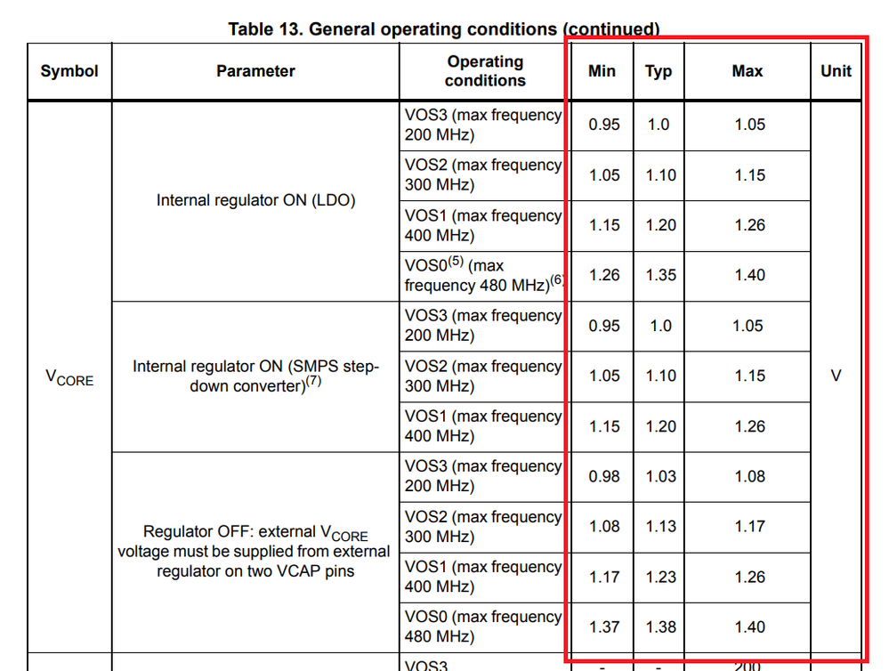

Check the VCORE voltage level versus the VOS you set and the power supply config in your software versus what is provided in the datasheet:
Ensure you have followed the hardware guidelines described in the application note AN4938 "Getting started with STM32H74xI/G and STM32H75xI/GMCU hardware development" especially the VCAP part:
Yes. These conditions are satisfied.
Attached the screenshot for your reference.
What about my first question? you need to monitor the Vcore voltage.

Measure VCAP voltage with an oscilloscope and check if there is a glitch / voltage drop.
This is likely a hardware design problem.
Why are there two grounds?
