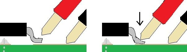

Hi ,i'm talking about STM32F410RBT
I'm using 12 ADC channels in DMA mode.I did any sort of manipulation around the hardware built on a prototype board,and it is not unlikely that something went wrong,despite only 3.3V are used.

Now what i see is that an ADC channel,say CH9,reflects its value on CH10 e CH11,that strangely does not move when a signal is applied to them.

Even hardwired the 2 ''strange'' ADC channels refuse to give a coherent digital value.That was too much...i lifted components around then put the circuit under microscope...the track looks non cutted,and checking with ohmeter once more confirmed connection between ADC pins and opamp out.Checking better i discovered the error:
Simply ,after one air removing and resoldering of a crystal close to the pins,the 2 pins of the interested channel remained sligthly llifted,so close to the track that the pressure of the multimeter probe tip was enough to reconnect it during measurement,due to the fact that the center of the uC was a bit lifted because of the thickness of ''handcrafted vias'' and some elastic force was present0690X00000602ntQAA.jpg
