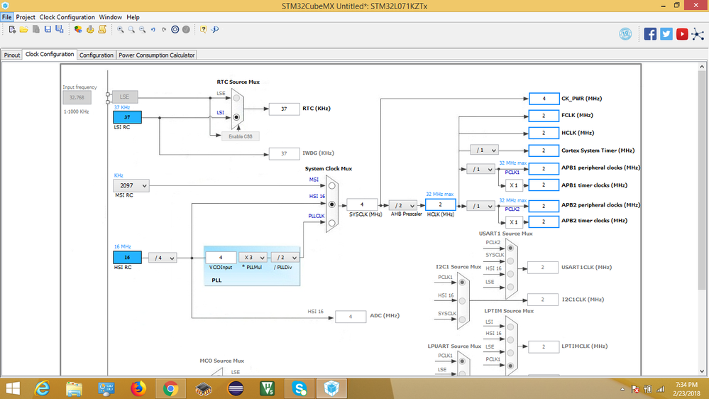

I have set internal clock frequency 1Hz but RTC time is faster than the real time
I have stm32l0 rtc clock LSI with 37khzPREDIV_A=125 andPREDIV_S =296

Posted on February 23, 2018 at 15:09
above image RTC Clock is 37khz
Posted on February 23, 2018 at 19:30
So, does that make the math work any better? 126*293 != 37000
a) You need to determine the frequency the LSI is actually clocking at
b) You need to review your options to trim that
c) You need to understand the gearing that divides that down
Perhaps review the Data Sheet
http://www.st.com/content/ccc/resource/technical/document/datasheet/b5/24/80/11/51/59/47/f7/DM00141136.pdf/files/DM00141136.pdf/jcr:content/translations/en.DM00141136.pdf
Typical 38 KHz, with a range 26-56 KHz

I have stm32l0 rtc clock LSI with 37khz PREDIV_A=125 and PREDIV_S =296
125*296=37000
 same problem
Posted on February 24, 2018 at 15:50
The formula is (
PREDIV_A + 1) * (PREDIV_S + 1), but have you MEASURED the frequency of your device?
If you want more accurate time use a crystal.
