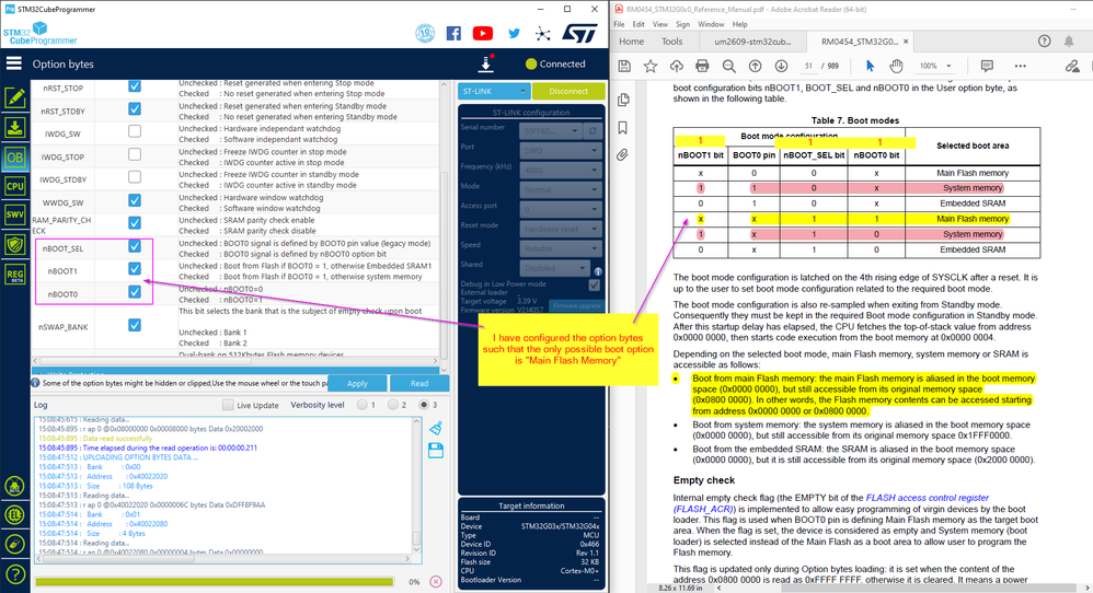

Using a STM32G0F06
I have a bootloader/application that I am debugging. I am facing a strange problem. Often, I command the app to drop to bootloader (via a software reset). When I execute the software reset code, occasionally the core locks up.
Here is a video showing the core registers and the disassembly as I step debug through the reset code:

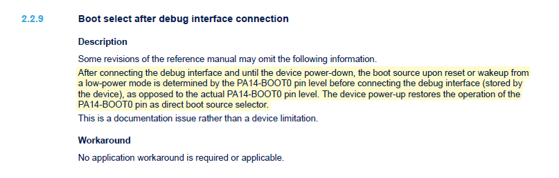

‎2023-05-29 12:41 PM - edited ‎2023-11-20 9:11 AM
Actually, I just figured out why this behaviour was occurring. This is from the STM32G030F6 device errata sheet:
I fixed it by:
- Flashing the app I wanted to debug
- disconnecting the debugger
- power cycling the pcba
- connecting the debugger (after app had already launched)
- now I can reset/reflash etc. as expected
‎2023-02-01 7:26 AM
It's either the application was not flashed or unstable BOOT0 input - the bootloader is invoked instead of your application
‎2023-05-29 12:24 PM - edited ‎2023-11-20 9:11 AM
The problem is that I have the option bytes configured to not care about the BOOT0 input (see screenshot below). From my research it seems like this should be impossible?
I fixed it by:
