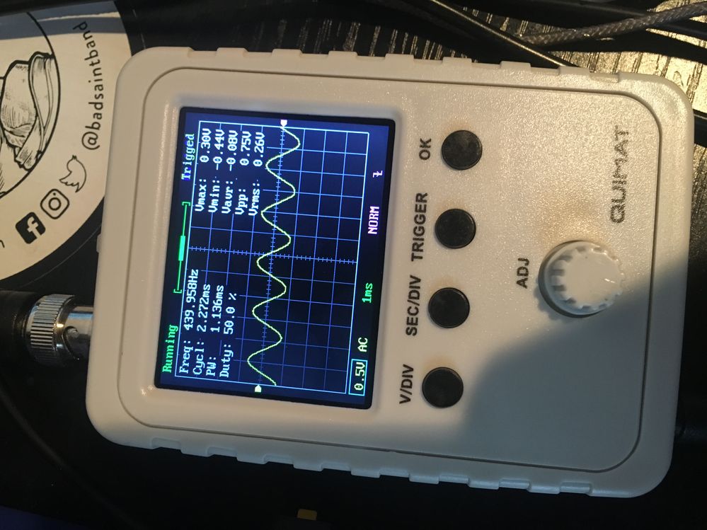

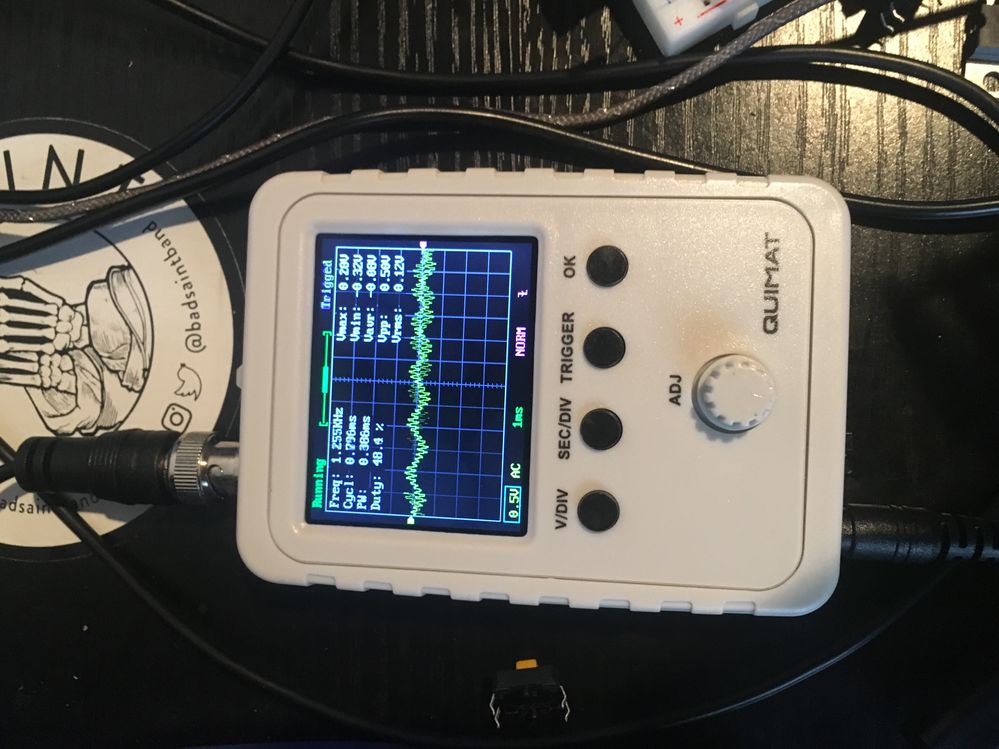

I'm getting a lot of noise from my STM32 design, which is just supposed to be direct line-in/out I2S with DMA.
I'm feeding in a 440Hz sine wave to my CS5343 A/D converter:
And this is the output I'm seeing from my CS4344 D/A converter:

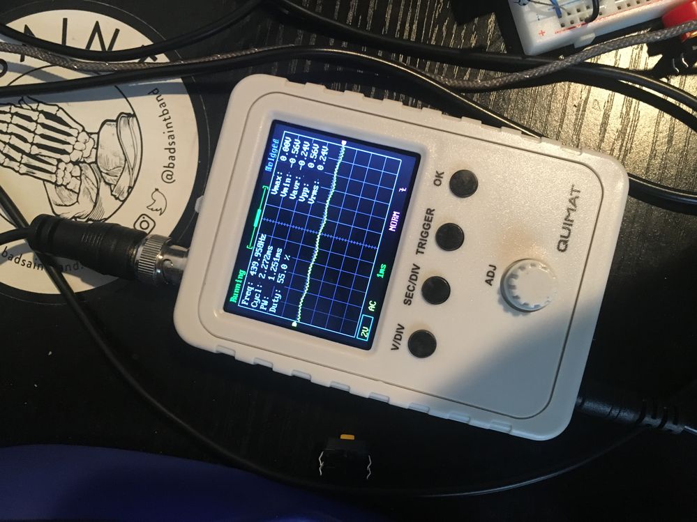

If I zoom out a bit, my oscilloscope does interpret the signal as 440Hz:
And when I plug the output into an amp I at least get a slightly imperfect A440 (it seems to go a little flat or sharp from time to time).
I know that there are algorithms for filtering/smoothing signals, but before implementing any of those I just want to make sure that this is a pretty standard level of noise to see, and that there's not something egregiously wrong with my setup.

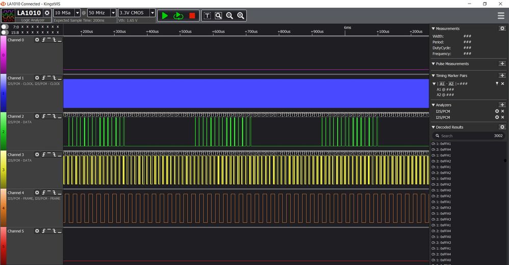

waclawek.jan
Divide and conquer.
Fill a buffer with a easily recognizable pattern - a sawtooth - and play it back.
Tried a TX sawtooth with the above configurations and changing the following:
void HAL_I2S_TxHalfCpltCallback(I2S_HandleTypeDef *hi2s) {
	for (int i = 0; i < AUDIO_BUFFER_LENGTH>>1; i++) {
		txBuf[i] = i;
void HAL_I2S_TxCpltCallback(I2S_HandleTypeDef *hi2s) {
	for (int i = AUDIO_BUFFER_LENGTH>>1; i < AUDIO_BUFFER_LENGTH; i++) {
		txBuf[i] = i;
The green data line is the output from the board. It transmits all indexes of the txBuf (0->15). But then between each transmit there is 16 cycles of zero.
I tried changing AUDIO_BUFFER_SAMPLES_PER_CHANNEL to a different number (2) and the same pattern showed: the system transmits 0, 1, then 2 cycles of zero, then repeats.
I'm not near my device at the moment but I think this might be the culprit:
  HAL_I2S_Transmit_DMA(&hi2s3, (uint16_t*)&txBuf, AUDIO_BUFFER_16BIT_LENGTH);
  HAL_I2S_Receive_DMA(&hi2s2, (uint16_t*)&rxBuf, AUDIO_BUFFER_16BIT_LENGTH);
I thought that the "Size" parameter was supposed to be the total number of samples transmitted per DMA cycle, but looks like it's actually the number of samples per half DMA cycle.

So I will need to verify when home, but I think this would fix the issue:
  HAL_I2S_Transmit_DMA(&hi2s3, (uint16_t*)&txBuf, AUDIO_BUFFER_16BIT_LENGTH>>1);
  HAL_I2S_Receive_DMA(&hi2s2, (uint16_t*)&rxBuf, AUDIO_BUFFER_16BIT_LENGTH>>1);
Also, somebody else in a different thread pointed out that my memory alignment settings might be wrong, and I think they're correct!
I tried to re-write the CubeMX-generated code to be flexible with me changing the data size settings (in i2s_audio_settings.h) but looks like I missed a spot (in stm32f7xx_hal_msp.c) (lines 47,48,107,108):
