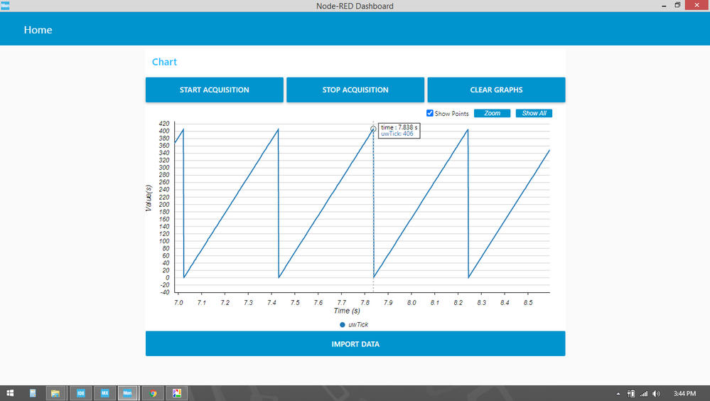

as you said i removed HAL_Delay() function and i monitor variable uwTick maimum value of variable is 406 then variable is automatically set to 0 you can see in below image.
that's the problem but why it get automatically reset to 0
so i check reset pins of MCU automatically pulled low continuous time interval so my MCU get RESET i don't know why its automatically pulled low?

Monitor RCC_CSR register at startup to determine the cause of reset.

I read rcc_csr before halinit function
It shows internal watchdog timer reset bit set
​I haven't set any watchdog timer in my program.
i preform full chip erase and then i read RCC_CSR it gives same value.
