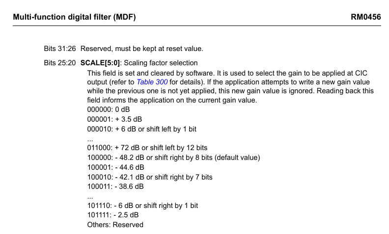

Is there a simpler way to compute the gain factor in the SCALE stage of the MDF?
_andreas
Senior
To me, it looks like each gain step shifts by "half" a bit, so we could compute the gain as
floor((DSfilt - DScic)*2);
e.g. with RSFLT as target and Sinc5/Dec5 + 14bit ADC1:
floor((22 - 25.6)*2) = -7;

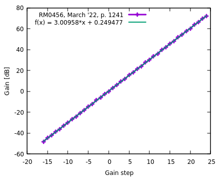

_andreas
Senior
20*log10(2)  = 6.0206 dB
If we shift by one bit, this would be the resulting gain in dB
