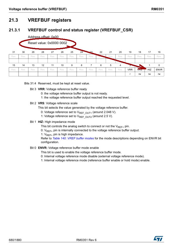

In the STM32l476, I have found that the VREFBUF_CSR

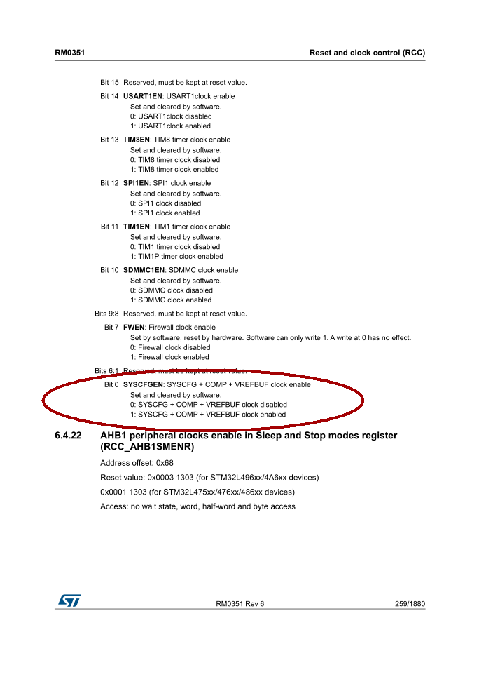

register 'HIZ' bit is being set from default 0 to 1 when SET_BIT(RCC->APB2ENR, RCC_APB2ENR_SYSCFGEN) is executed.  RCC_APB2ENR_SYSCFGEN is the LSB.

    VREFBUF_CSR.HIZ is by default 1:
    However, reading VREFBUF registers returns all 0 until VREFBUF clock is not enabled in RCC.
    And it so happens, that VREFBUF shares its clock-enable bit with SYSCFG (and also COMP):

    Thank you https://community.st.com/s/profile/0050X000007vqmpQAA, I hadn't noticed the default setting of HIZ being 1 according to RM0351.  Yes the value of VREFBUF_CSR is all zero at startup, and remains so until RCC_APB2ENR bit 0 is set.
