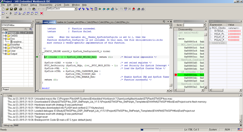

just4you
Posted on July 23, 2015 at 14:13
Sorry about the fault of my code. The other project code is copied.
I tested again with my system.
- STM32F4-DISCOVERY
- Third Party Development KIT
- My custom board
1. The generation code for STM32F4-Discovery works well.
    The system clock value is 168M.
2. The generation code for third party dev kit does not show the Max Speed 168M. just only 16M.
    However, STM32F4-Dicovery show the max speed 168M.
    The modified standard peripheral library code for third party dev kit works well.
    (just only the HSE_VALUE as 8M, PLL_M as 8, and PLL_N as 336)
3. The generation code for my custom board does not show the MAX Speed 180M. also just 16M.
    However, the Standard Peripheral Library code works well in my custom board.
    The system clock speed show 180M.
    (HSE_VALUE as 26M, PLL_M as 26, and PLL_N as 360)

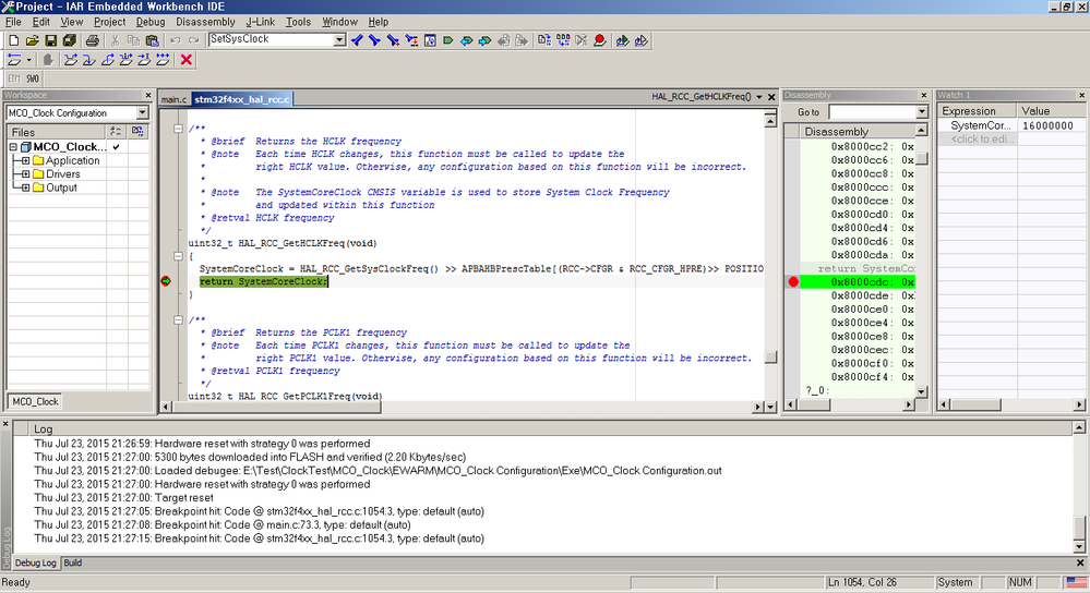

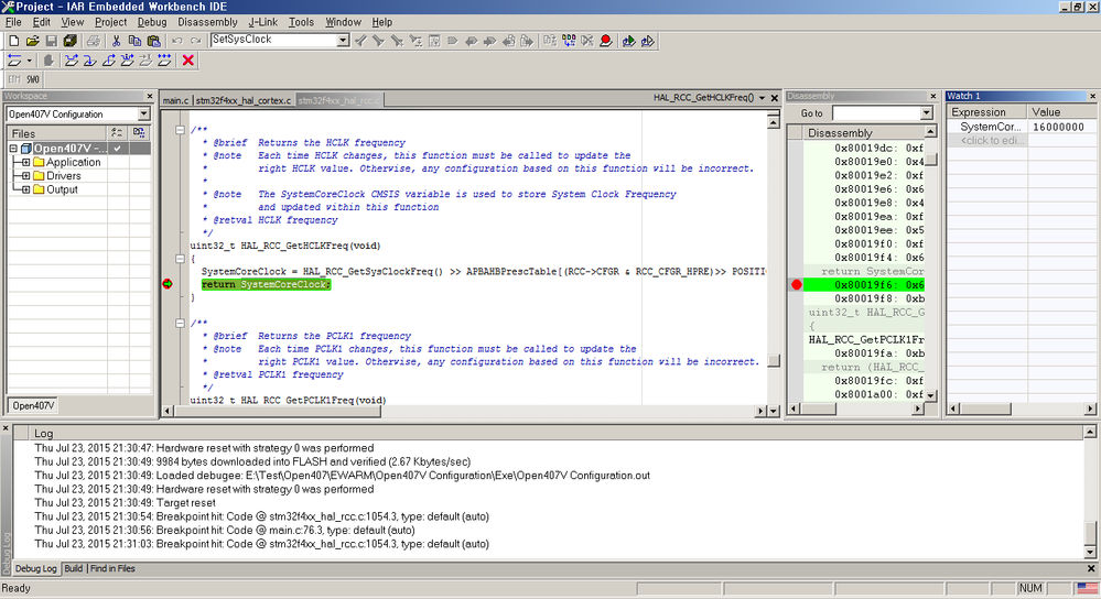

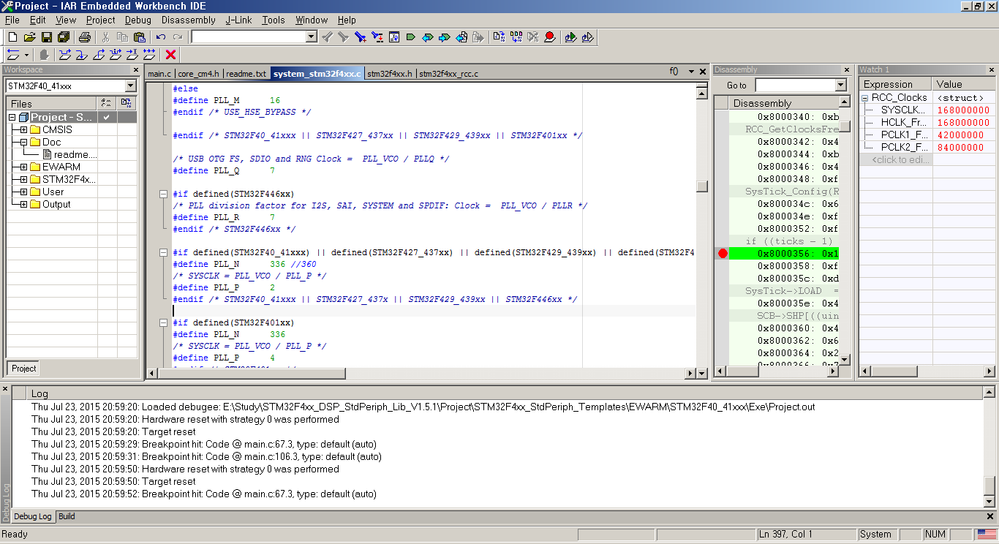

The following is my capture of the system clock speed.
- CubeMX generated Code for Third Party Dev Kit
- Standard Peripheral Library for Third Party Dev Kit
- CubeMX generated Code for Custom Board
- Standard Peripheral Library for Custom Board
The CubeMX generated code shows just only 16M, but the Standard Peripheral Library code works well as 168M and 180M.
Why the difference happens?

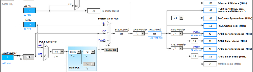

Please use the same configuration as in this figure
-Syrine-

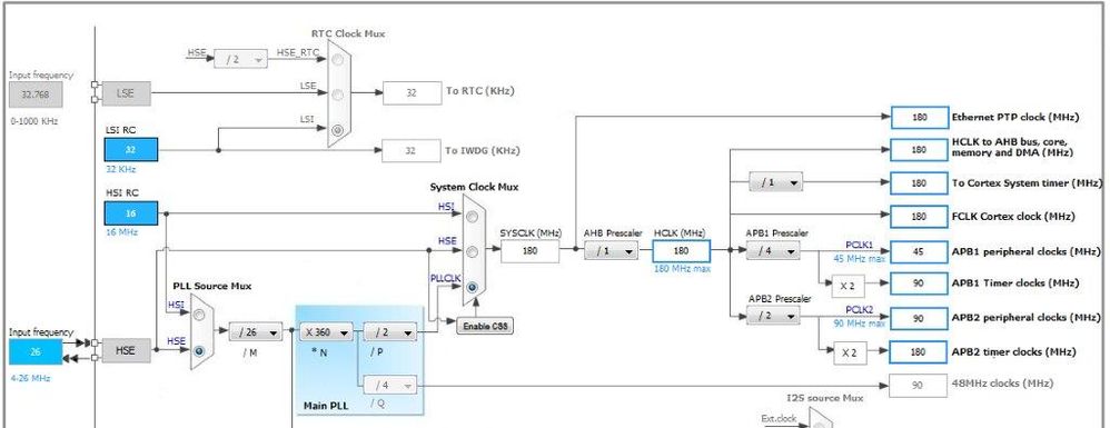

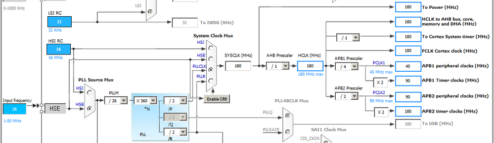

Posted on July 27, 2015 at 11:58
This is my clock configuration for CubeMX.
Do you want this configuration?
I wonder that the difference between Discovery and tird party development kit.
- Clock Configuration for Custom Board
