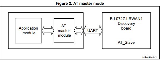

My purpose is to realise a new set up for LoRa.
Before, I used a B-L072Z-LRWAN1 board with the I-CUBE-LRWAN1 software with the End Node code or the AT SLAVE code.
For the AT_SLAVE code, I used a terminal to send AT COMMAND to the MCU of my LoRa module.
Now, I want to configure my B-L072Z board with the AT_SLAVE code (as I realized before) but send AT_COMMAND with a Nucleo_L073RZ board with the AT_MASTER code (and not with a terminal). In comparison with this picture, I don't have application module and my AT_master module will be a the Nucleo_L073RZ board.
Is it possible? Is the AT_MASTER code functionnal with a Murata LoRa module?
Should I just connect Tx-> Rx and Rx_>Tx and GND of the two board to communicate (UART) or there is some modification with jumper?
Thanks in advance!
Max

>>Is it possible?
Yes, but is complicated on the NUCLEO and DISCO boards as the USART are connected to the ST-LINK/VCP. You will need to review the schematics to determine the connectivity and solder-bridges, and disconnect the USARTx_RX pin from being driven by the ST-LINK.
The DISCO is designed for you to implement the entire LoRa app, and thus avoid the need to go via the AT command protocol.

I don't believe it is too complicated, but does require an appreciation about the connectivity, and software/pins. I would expect I2C and SPI to be viable paths, but require more code ownership and change.
The original AT command firmware is expecting to use the USART via PA2/PA3 (LPUSART1), using a different USART on PA9/PA10 (USART1) will require adjustments in the code.

This might be too late for you, but it might be helpful for others who want to interface the Murata module on the
B-L072Z-LRWAN1
board with a micro-controller (uC) using the UART used in the AT_Slave example.
As
Turvey.Clive.002
‌ said, it can be done by removing solder bridges.
To be specific (from the
B-L072Z-LRWAN1 schematics)
, if you remove the
SB28 and
SB29 solder bridges, then it disconnects the Rx and Tx lines from the ST-Link and you can use them directly for interfacing with a different uC. Should be pretty straightforward.
