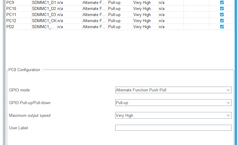

I followed example from CubeMX to connect 2 Nucleo boards F446, using I2C and they use internal pull up and it does work. I wonder if I can use for example internal pull up for example for SDMMC.
What was the clock speed used in this example?
Keep in mind that this 40 kΩ weak pull-up in combination with line and input capacitances is forming a low-pass filter.
So it depends how long and wide your PCB traces are (rule of thumb is 1 pF/cm length for 0.2mm trace width and 0.2mm height above plane - prepreg thickness) and how many slave devices you have on the bus (I/O pad capacitance - around 5 pF per pad).
For example a 10 cm PCB trace (10 pF) + input capacitance (5 pF) = 15 pF
which gives a rise-time of 1.3 us so not good at all for anything above around 500 kHz.
