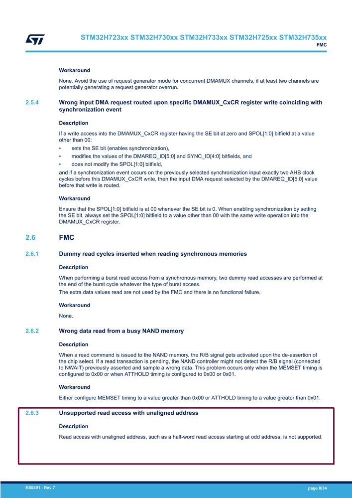

waclawek.jan
0693W00000aJh9IQAS.pngThat you were able to perform some unaligned accesses, may be coincidental.

waclawek.jan
Hi @Douglas MILLER​
> will be handled off-line
Why? What's so secretive on this case? Couldn't we all learn from it being discussed here, publicly?
waclawek.jan
@guenniause,
-mno-unaligned-access may be buggy, or dependent on some particular setting or circumstances... I've just tried your snippet (modified to add more volatile, to prevent compiler to guess the result and remove portions of code)​ with gcc v9.2.1 and cortex-m4, and it indeed did split the unaligned halfword access to two byte accesses, but left the unaligned word accesses.
OTOH, detecting indirect unaligned accesses (i.e. via calculated pointer) is not entirely trivial. You may be better off by writing your program so that it explicitly won't attempt unaligned accesses. I understand that this may be not trivial. You may also consider some other target mcu, one which does not have this limitation.
