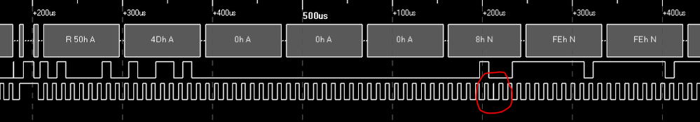

I am using microcontroller STM32F On reading EEPROM operation with I2C microcontroller gives 7 clock pulses instead required 9. There is fragment of transmitting on picture.

Flags ARLO, BERR, OVR are not raised.
How do I resolve this problem?

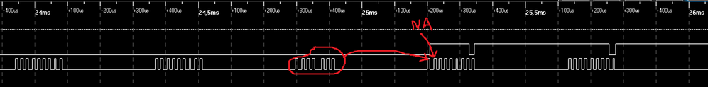

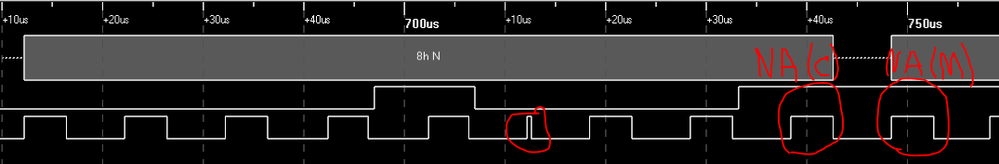

Using I2C optimized library does not resolves this problem.
When I increased frequency of capture I found other reason of problem. Lost clock pulse exists but it is so short and EEPROM can not send bit over it.- Mark as New
