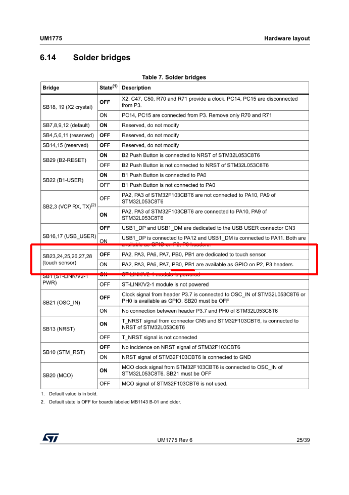

I have set PB0 and PB1 as EXTI. Also set pin PB2 and PB3 for EXTI inturrupt mode as well. But for PB0 and PB1 interrupt never occurs whereas PB2 and PB3 always working perfectly. What could be the issue. I have attached the sample code below. Can someone please help?

With EVAL/DISCO/NUCLEO boards, always start with checking internal connections.
TAmi.1
Thanks a lot. Solved the issue
