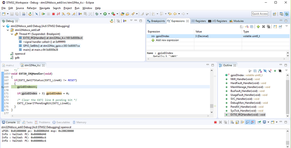

Posted on October 30, 2017 at 16:20
Your code run correctly for me (see capture below)
Breakpoint is reach when PA0 [USER_BLUE_BUTTON] is pressed and PORTD LED onbard are set.
I can share with you SW4STM32 project. But I'm use Windows OS.
To see if interrupt occurs, you must place a breakpoint into EXTI0_IRQHandler() and run the debugger.
