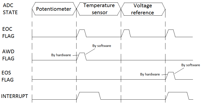

I understood.
I have a three ADC conversion:
  1. Potentiometer
  2. Temperature sensor
  3. Internal voltage reference
I have a two flag which generates interrupt:
  1. AWD flag
  2. EOS flag
AWD flag is generated at the same time as the EOC flag. Timing diagram:
Because is generated two interrupts.
Conversion:
  1. DISABLE interrupt from AWD flag.
  2. Clear AWD flag in handler from EOS flag.
ADC Handler:
void ADC1_IRQHandler(void)
   if (ADC1->ISR & ADC_ISR_AWD1) {
      ADC1->ISR |= ADC_ISR_AWD1; // Clear flag
      state = STATE_AWD;
   } else {
      state = STATE_OK;
   ADC1->ISR |= ADC_ISR_EOS; // Exclude the cause of the interrupt
   debug_send(state); // uart sender
