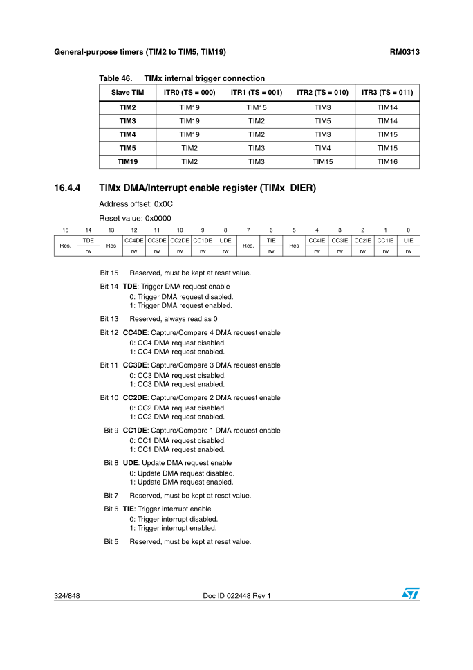

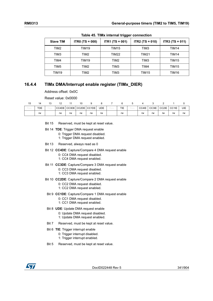

Hello,I'm using STM32F373CBT6 in my project and I've  noticed that TIM3 is triggered by TIM19 when ITR=0 and not TIM2 as stated in table 45, page 341 of RM0313 Reference manual. I checked the errata notes and didn't find anything relevant.Anyone had this issue before/can verify?Thanks,Stratos

That table is a bad joke - there are no TIM21 and TIM22 in 'F373 either.
This was in rev.1 of the same RM. Spot the differences.
It's a shame that users replace ST's document quality control.

I have just reviewed it again and agree with you that the current content of the table 'TIMx internal trigger connection' in RM0
It is reported and should be fixed in next revision of RM0
-Amel

A new revision of
http://www.st.com/content/ccc/resource/technical/document/reference_manual/fa/06/c7/15/3b/2a/4c/f1/DM00041563.pdf/files/DM00041563.pdf/jcr:content/translations/en.DM00041563.pdf
 fixing this error was delivered on March 2018.
