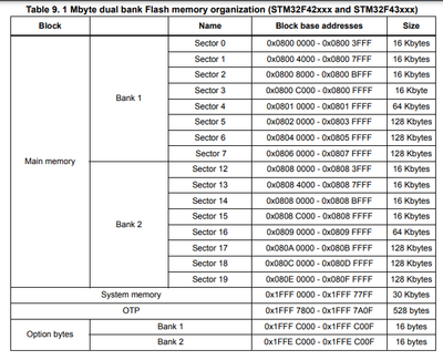

I am reaching out regarding a query about the STM32F407G-DISC1 target. Upon reviewing the datasheet, I noted that it indicates the target does not support reading while writing. However, upon personal experimentation, I found that it functions correctly in this regard.
Could you kindly provide clarification on this matter? I am curious to understand why my observations differ from the information provided in the datasheet.

STM32F407 does not support dual bank feature while for example STM32F42xxx and STM32F43xxx do.

Are you talking about the Reading while Write to the Flash memory?
PS: This is NOT an online support (https://ols.st.com) but a collaborative space. So please be polite in your reply. Otherwise, it will be reported as inappropriate and you will be permanently blacklisted from my help/support.
yes reading while writing in flash memory
Ok but you need to provide more details about this statement ..

I am currently working on implementing a full Firmware Over-The-Air (FOTA) project on the STM32F407G-DISC1 target. As part of this project, I am considering dividing the flash memory into two banks.
My primary query pertains to whether the STM32F407G-DISC1 supports executing code from bank1  while writing to another bank2
