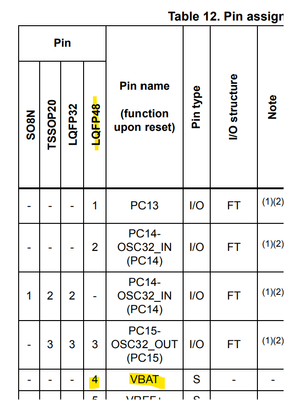

STM32CubeMX has a part selection that can be helpful here.
You're probably out of luck here with the VBAT pin requirement. All chips have RTC/I2C.
No SO-8 chips have a VBAT pin. The STM32G0 series has that pin, but only in the LQFP48 packet. My guess is other series are similar.

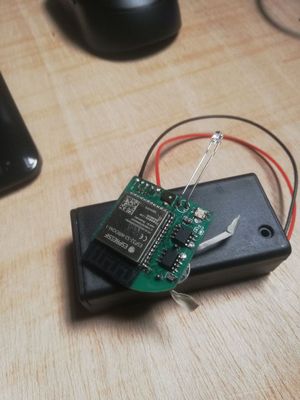

I am creating a light-based alarm clock that simply turns on an RGB LED according to the wake-up time.
The code is very simple:
  • A wakeup interrupt is configured, and the system is put to sleep.
  • When the set time arrives, one of the three RGB colors is activated based on the minute range of the hour: 0-15, 15-40, and 40-59. If the set time is exceeded, a color blinks according to the delay in hours to the wake-up time. Blue, green, red represent 1, 2, 3 hours, respectively, following the same pattern for minutes. This way, we can know the time without looking at the clock, simply by the blinking of an LED. This doesn't disturb anyone who may be sharing the bed. In short, very little code. Only an I2C is programmed to control the LED, and the microcontroller goes to sleep until the next color change and blink event.
I'm not brave enough to solder the QFN yet.

Soldering an LQFP is doable. Not as easy as SO-8 but it can be done with hobby-quality tools if you have some patience, flux, and a solder wick.
Hello and thank you, I found this:
https://www.lcsc.com/product-detail/Microcontroller-Units-MCUs-MPUs-SOCs_STMicroelectronics-STM32G030C8T6_C529329.html
You have many pins that will be unused, but it's the smallest one I found with VBAT.

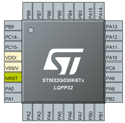

The STM32G030K6T6 (LQFP32) does not have a separate VBAT pin. Only LQFP48 chips from that series have one.
Yes, I realized after posting, it's already corrected.
Thank you very much anyway, you are very kind.
pumarada
Currently, I am using this one, but it costs 5€, and the STM32, besides saving me the external RTC, doesn't even reach 1€, and that is magnificent!!
